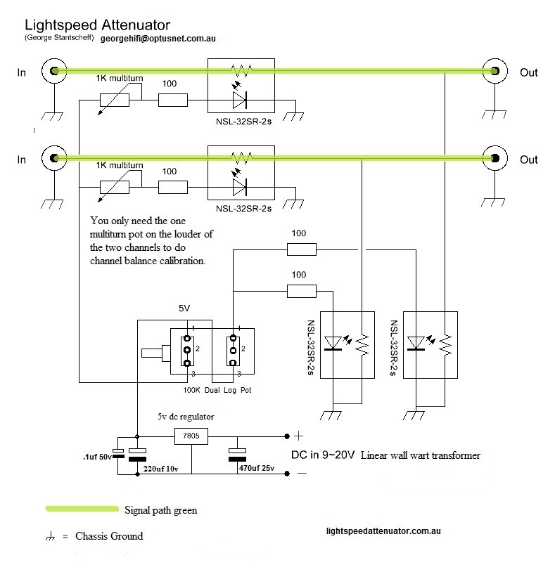

His ‘Attenuator’ uses LED light transmitting optocouplers instead of metal contacts. Here is a brief explanation of this ‘revolutionary’ approach from the website, DIY Audio Projects: http://diyaudioprojects.com/Solid/DIY-Lightspeed-Passive-Attenuator/
"What makes this passive preamplifier interesting is that there are no contact points in the form of a "wiper" as in the case of a potentiometer or "switches" as may be with a discrete stepped attenuator. The key components in the Lightspeed Attenuator are Silonex NSL-32SR2 Optocouplers (PDF - 34kB). The optocoupler device is a sealed unit which consists of a high performance LED that shines on a light dependent resistor (LDR). The operating principle of the optocoupler is fairly simple. As the intensity of the LED varies, so does the internal resistance of the LDR (resistance decreases with increasing light). So in the case of the Lightspeed Attenuator, we change the volume (resistance) by changing the intensity of the LED. By using a series and shunt combination of optocouplers the attenuator can be configured to produces a constant input and output impedance, regardless of where the voltage control setting is.”
George’s LightSpeed Attenuator needs an AC to DC converter to light the LED optocouplers and can stay on all of the time with the volume controls set at half, or lower, as in my case, with an estimated LED optocoupler ‘life’ of 50 years. I wish the tubes used for the Yamamoto could last 50 years!

Hi Richard, just have to correct a couple of points you made above using words that can be misconstrued by some.
The Lightspeed Attenuator uses "matched quads" not matched pairs as other do, this allows for not only better sound but for a more progressive feel to the volume control, and better low level min volume.
As for where you used the word the "remote" the first time, that should be "a active forced matching circuit". I don't believe in these, as they can and will over (safe) current the LDR's that need more mA put into them to keep up with the others, which can and will over stress them and cause failure in the long term.
As well as this type of circuit can be detrimental to the sound as they are attached to the signal output just like an active feedback network is, and need to constantly sens re-adjust each time the volume is changed. So in effect these types of Lightspeed cannot be called passive, as they have this active network attached to the signal output.
As for the use of remote controls for volume adjustment, I have no problem with this, but it is almost impossible to find after market ones of very good quality, that will last the distance, so I prefer not to, because those types of suppliers for Asia are here today gone tomorrow, and I know they will go faulty sooner or later mainly the remote buttons go first.
BTW: here is the circuit if someone with the skills wants to make one for themselves. Please ask any questions here, if you need help building this.
Cheers George and to all have a Merry Xmas and happy New Year.
