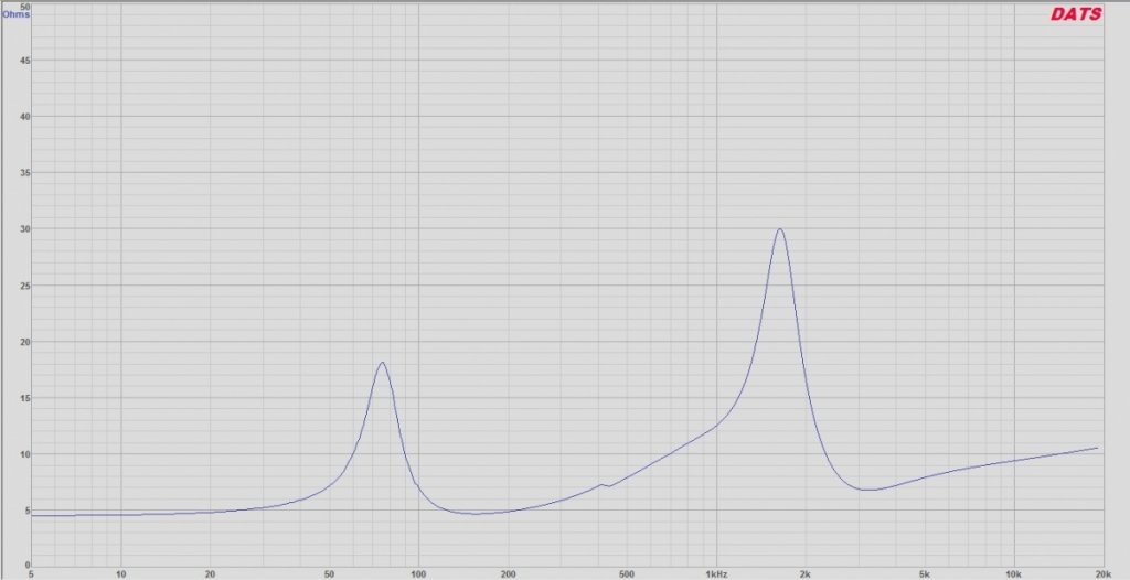

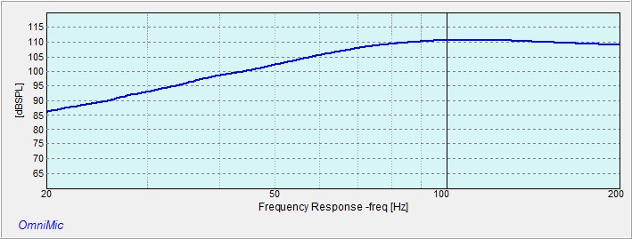

« Reply #19 on: 12 Jan 2016, 06:07 pm »
As promised, some performance graphs. Please note the on/off-axis curves are ungated in order to show the full in-room response below 200hz so there is more ripple in the curve above 200hz than normal. The 20-200hz bass curve is nearfield - no room gain!
