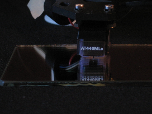

Wayner
Re: Difficulty setting up Pro-Ject Xtension 9 Evolution turntable
« Reply #16 on: 31 Oct 2015, 04:42 pm »
You can check it with a flat mirror too.
Look at your cartridge/stylus/cantilever at the same time you look at the image in the mirror. Both should appear straight to each other. This technique doubles the error.
'ner

The electrical meter is better than a mirror for adjusting azimuth (use an allen wrench to loosen the screw on the back of the tonearm, behind the pivot housing, after which you can rotate the tonearm), but better than that is actual phase measurements using Adjust+. A meter is better than a mirror because the meter will account for the internals of the cartridge whereas the mirror only looks at the stylus relative to the shell. And Adjust+ is better than the meter because phase might still be many degrees apart while amplitude is almost equal, and phase is what you really want to get right.
