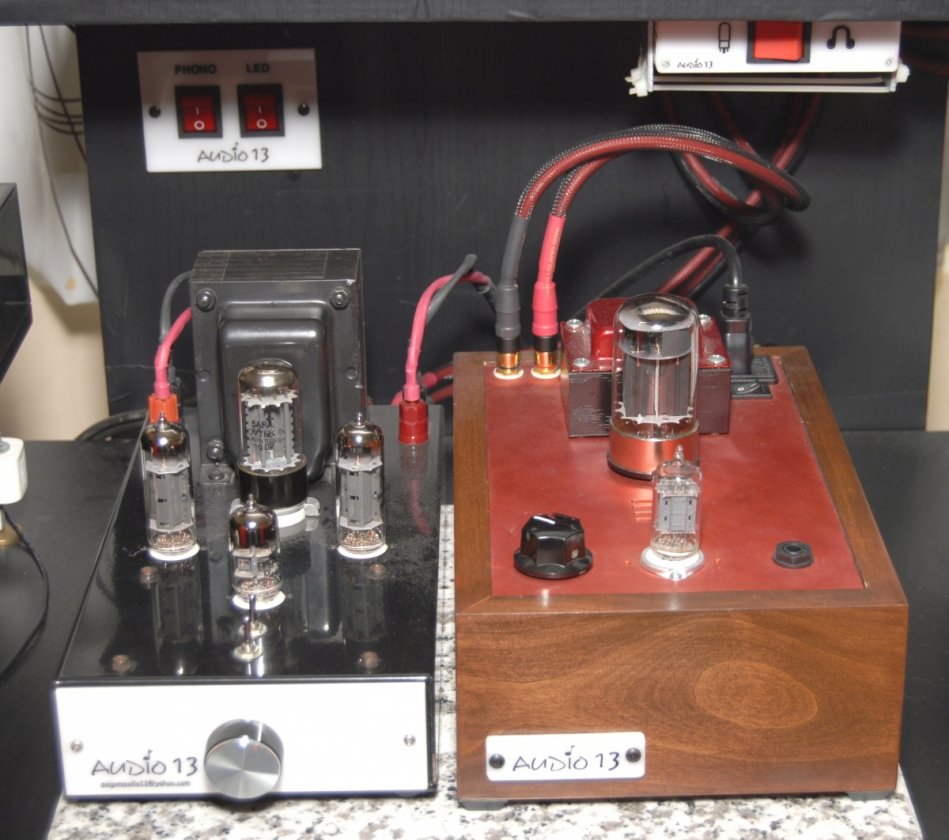

Guy 13
Re: Need Tube Head amp & Phones ?? Help !
« Reply #11 on: 21 Oct 2015, 09:28 pm »
One more vote for the Bottlehead Crack with HD650.
No speed ball up grade and it sounds good anyway.
I did lots of tube rolling,
but did not hear much difference-improvement between makes,
models, new or NOS.
Can't go wrong with that combo or any other head phones.
Guy 13
