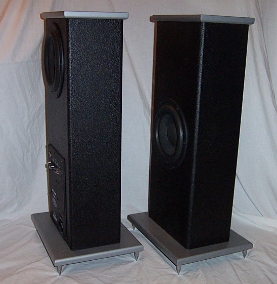

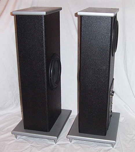

Unless you decided to put a pair of the X-LS or X-CS Encores on a pair of Danny's Best Speaker Stand Ever.  Now that would be one heck of a combo.   http://www.audiocircle.com/index.php?topic=129161.0  Here's a couple of pics Danny posted in his thread:
Using these as stands will relieve any worries about not having enough bass in the system

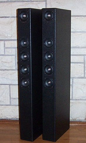

You also might want to give serious consideration to Danny's newest design, the Skinny 6
http://www.audiocircle.com/index.php?topic=135458.0  Here's a couple of pics of them from Danny's thread:
Yes they are towers but the pictures make them look a lot bigger than they really are. At 4 1/2"W x 13"D x 41"H they are small towers but from what Danny says with really big sound. From my experience with these LGK drivers in my desktop speakers and Wedgies I can believe it.  Since the Skinny 6's are -3dB at 70Hz you would need one of the servo subs to go with them.
Another option would be the bookshelves paired with one of Danny's 12" sealed servo subs. In my living room I have a pair of N3 towers (the ones in my avatar) paired with one 12" sealed servo sub. I cross the towers to the subs at 40Hz. With the X-LS Encores, X-CS Encores or the Skinny 6's you would cross over to the subs around 80Hz.
If you have never heard one of the GR-Research/Rythmik Direct Servo subs you might be inclined to think sub woofers cannot be musical nor could they blend well or keep up with main speakers. Nothing could be further from the truth with these.

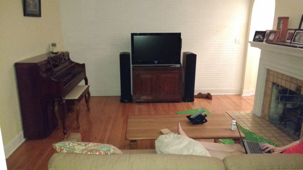

The room is 13 feet wide and 18 feet deep. The couch is 12 feet from the wall.
I like the idea of smaller speakers with a subwoofer. Anything too far from the wall will interfere with the doorway, so I would like to have the speakers against the wall. I realize this is not ideal.
So if you to choose a model of GR Research speakers to put on a shelf next to the TV, with a sub, what would you recommend?

Post your location and ask if there is anyone local who can help in any way. Speakers are expensive to ship so local purchase from a trusted AC member could be advantageous in several ways. That said, your room has many challenges. First thing would be separate  your speakers as much more as you can. Cover your floor with a thick area rug.
If a complete makeover is a consideration, investigate the world of professional studio monitors which are designed for near field listening. On a whim, I bought a pair of discontinued KRK Rokit 8 active monitors. They aren't the last word in detail but provide very surprising bass performance and convey your music and video dialogue quite well. These can be found online for under $500/pr. There are other, and perhaps better, options out there from companies like Emotiva, JBL, Neumann, etc.
That takes care of amps and speakers. Consider an Emotiva Stealth DC-1 to use as DAC/preamp. It is a DAC with multiple difital inputs, an analog input, and a remote for $500 or less depending on the deal you can find. Worth considering. It's really a whole new system. You'll want to use your current sources and pick up a pair of balanced cables to run between DAC and speakers.
I can't see the rear of your room but perhaps a closely configured system at the far end might work better acoustically and logistically. Putting the piano as far as possible from your speakers might provide benefit as well. Stringed instruments have a tendency to resonate at certain frequencies in sympathy with your speakers. Maybe the piano would work well where the system is now.
Good luck. It looks challenging.

You do have a challenging room. You have a lot of up side potential. And just how good you want it to sound will depend on how much effort you put into treating your room and controlling room reflections.
Spreading your speakers out is a good start.
Treat the bare wall behind the speakers. There are a lot of options here. I'd be inclined to start with fiberglass duct board. It is a compressed fiberglass with an aluminum foil backer. It is used for making air conditioning ducts and is cheap and commonly available. It is also real easy to wrap with fabric that matches your wall and simply tape it to the foil side with duct tape. Then just hang them on the wall.
A big throw rug on the floor will help a lot too.
The corner to the left could use some type of a tube trap. You can DIY that too.
As for speakers any of our small stand mounted speakers will play down low enough to reach a sub and be just as solid through the 100Hz to 200Hz region as any large driver speaker. Most of our mini monitors will play down to 55Hz or so. And you have plenty of room for a small sub.
You can even build a sealed version of the X-LS for close wall placement. And they are far more accurate than most of the recommended studio monitors. And I have measured and test a bunch of them. Most of the active models use really cheap amps and the combo typical sounds like they are playing through a wet rag.
Keep in mind though that a stand mounted mini monitor takes up just as much floor space as a floor standing speaker. So you could go with the A/V-3 and flip flop the design to allow the transmission line to exit out the front.  That would be a big performance jump for you.
Another thing to consider is that you can move your speakers well out into the room for critical listening enjoyment. Then move them back to the wall for background music.
