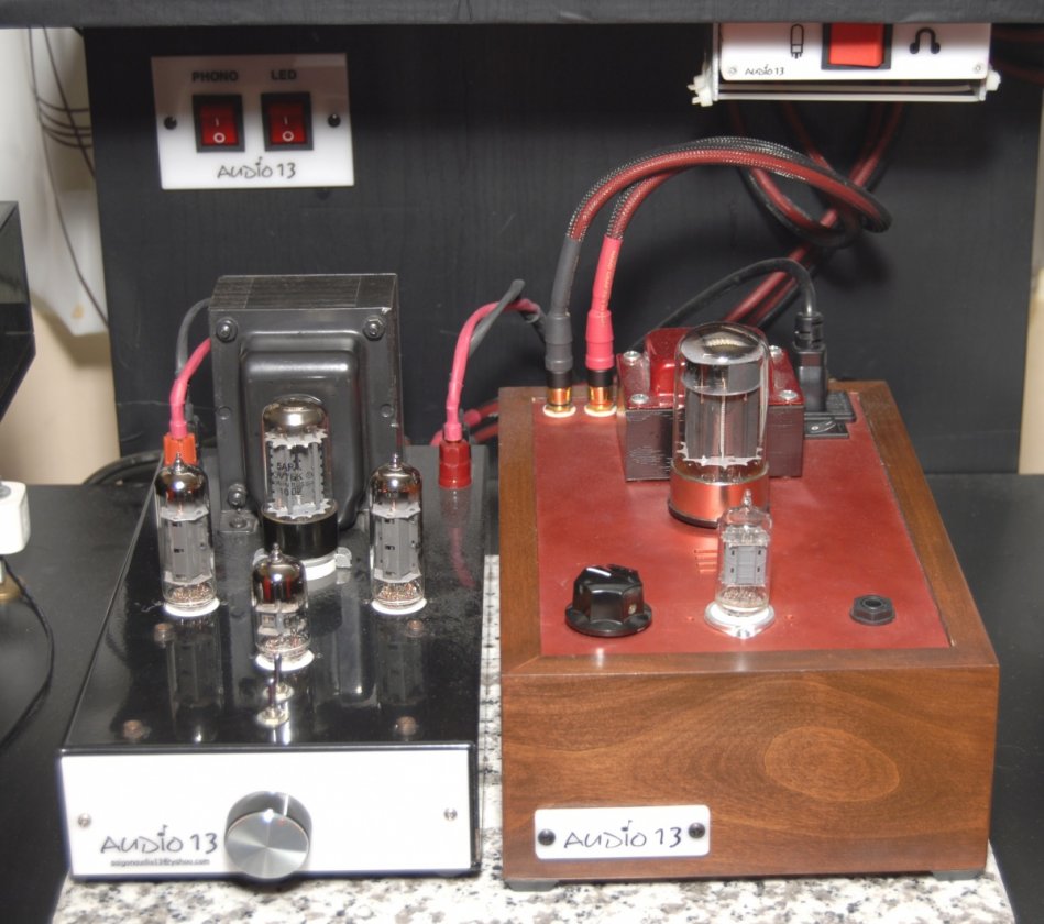

I have a Bottlehead Crack headphone amplifier
and many DIY guys on different forum (Mainly on Bottlehead forum)
say that it's easy to put together and support is second to none.
Circle is point to point and simple.
There are many up-grades and tube rolling is almost unlimited.
All their units are very affordable.
Mine was built by a AudioCircle member,
because my eye sight is not too good and he did a better job than me with the wood and top plate.
I will try to download a picture, I hope I will succeed.
Guy 13
