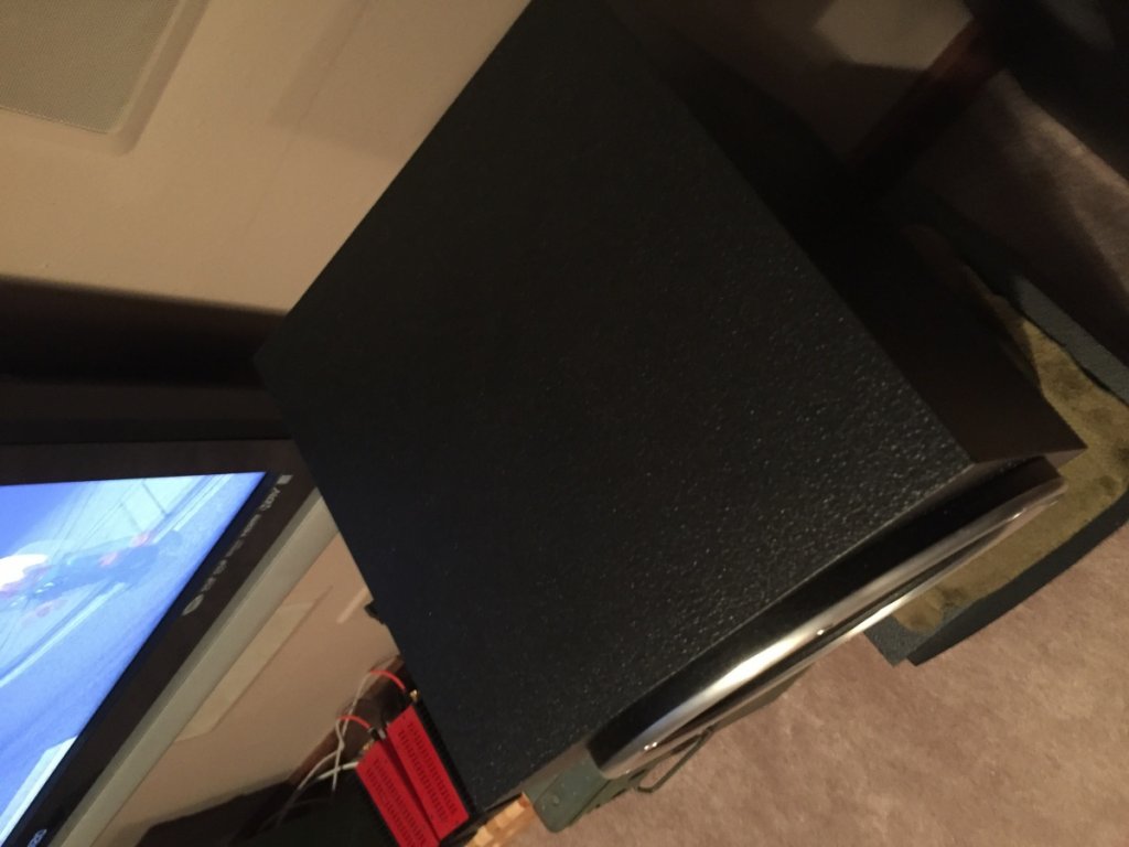

For the Duratex, did you add water to thin it down, how many coats did you apply, and how did you apply the paint?
Michael
cody69
Re: X-LS build question
« Reply #61 on: 26 Dec 2015, 12:45 pm »
I've done it both ways and have had equally good results by thinning and by not thinning. Last weekend I coated a pair of X-LS and used a small textured 4" roller that I dipped into the quart can of Duratex. I used two coats, smoothing out the final coat so the finish was not overly aggressive. Great stuff and simple to use.

Thanks guys.  I applied three coats of Duratex straight from the can with the supplied roller.  I did try and gently roll the second and third coats so the texture was less aggressive.  Danny is right these kits are the bargain of the century!
