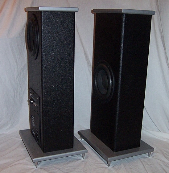

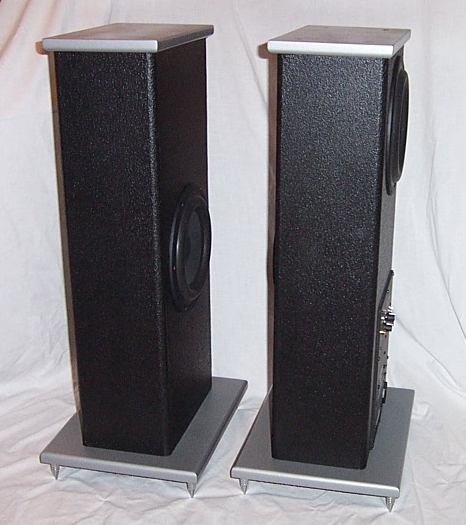

The X-LS or X-CS Encores would need speaker stands. The speaker/stand combination doesn't take up any more floor space than the towers do and the cost of the extra wood is usually cheaper than the cost of a good pair of stands. Going with the floorstanding version would give you a lot more bass extension than either of the smaller cabinets would.
Unless you decided to put a pair of X-CS Encores on a pair of Danny's Best Speaker Stand Ever.  Now that would be one heck of a combo.   http://www.audiocircle.com/index.php?topic=129161.0

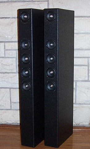

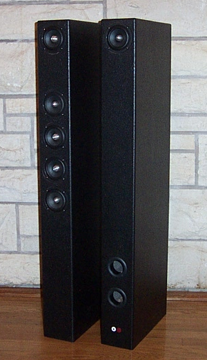

You also might want to give serious consideration to Danny's newest design, the Skinny 6
http://www.audiocircle.com/index.php?topic=135458.0
Yes they are towers but the pictures make them look a lot bigger than they really are. At 4 1/2" wide x 13" deep by 41" tall they are small towers but from what Danny says with really big sound. From my experience with these LGK drivers in my desktop speakers and Wedgies I can believe it.

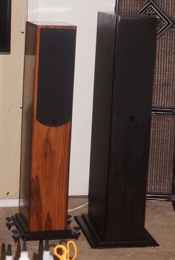

Here are the the X-MTM Encores compared to the N3TL's. The ones with the Rosewood veneer are the N3TL's
It is not an optical illusion, the N3's are smaller than the MTM Encores.
Mike

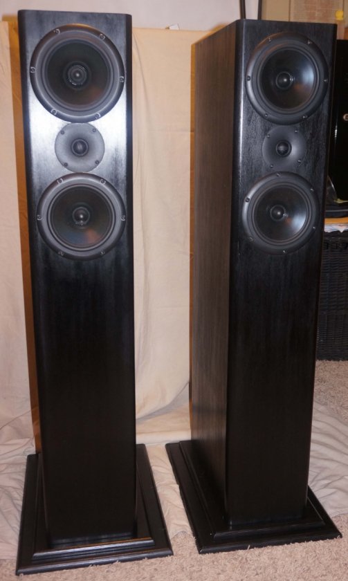

« Reply #54 on: 26 Dec 2015, 04:20 am »
Sorry for the delay but I have a few final pictures showing the stand construction with finished pictures.  I really appreciate all the help I have received along the way...I learned a lot.  I borrowed the stand design for one of the posts on this site with a slight modification.  I used his PVC idea for the threaded rod but then I added an extension to the rear of the stand to allow the speaker cable to be threaded thru the stand so you won't see it handing from the speaker.  You can see it on the last glue up picture.
kwhitman
Re: X-LS build question
« Reply #55 on: 26 Dec 2015, 04:25 am »
A few more of the stands getting built.  I think you can see it better assembled.  The finish is black Duratex I purchased from Danny.
kwhitman
« Reply #56 on: 26 Dec 2015, 04:31 am »
I should have added a little roundover on the stands before appying duratex.  I also rounded over the speaker cabinets with a 3/8 roundover bit.  I was limited with the roundover because I used biscuits during the box construction so I did not want to take a chance of getting into that slot.  Here are a few finished pics.
kwhitman
« Reply #57 on: 26 Dec 2015, 04:41 am »

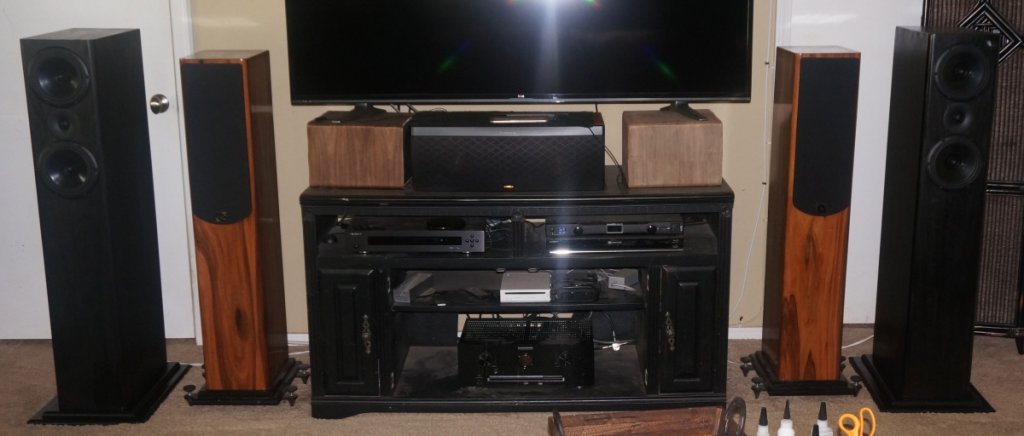

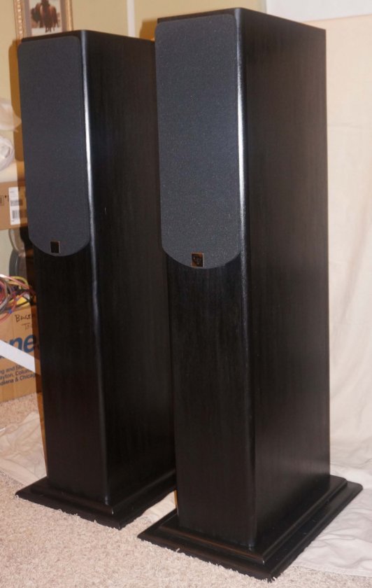

Last batch showing speakers wearing the speaker covers.  The badge on the grill is a small rat.  You would have to understand the importance of this addition.  For most of my daughters young life I had a nickname for her...I always called her RAT.  The badge was my way of making these speakers personal.  She cried when she saw them....then she cried some more when she heard how awesome these little boxes sound.  I would assume this is exactly why people choose to build over buy.  I hope you guys like the finished product.
I know the placement is terrible...I was trying to stash them back out of the way of our young and high energy German Shepherd :green:  We did pull them out when listening.
