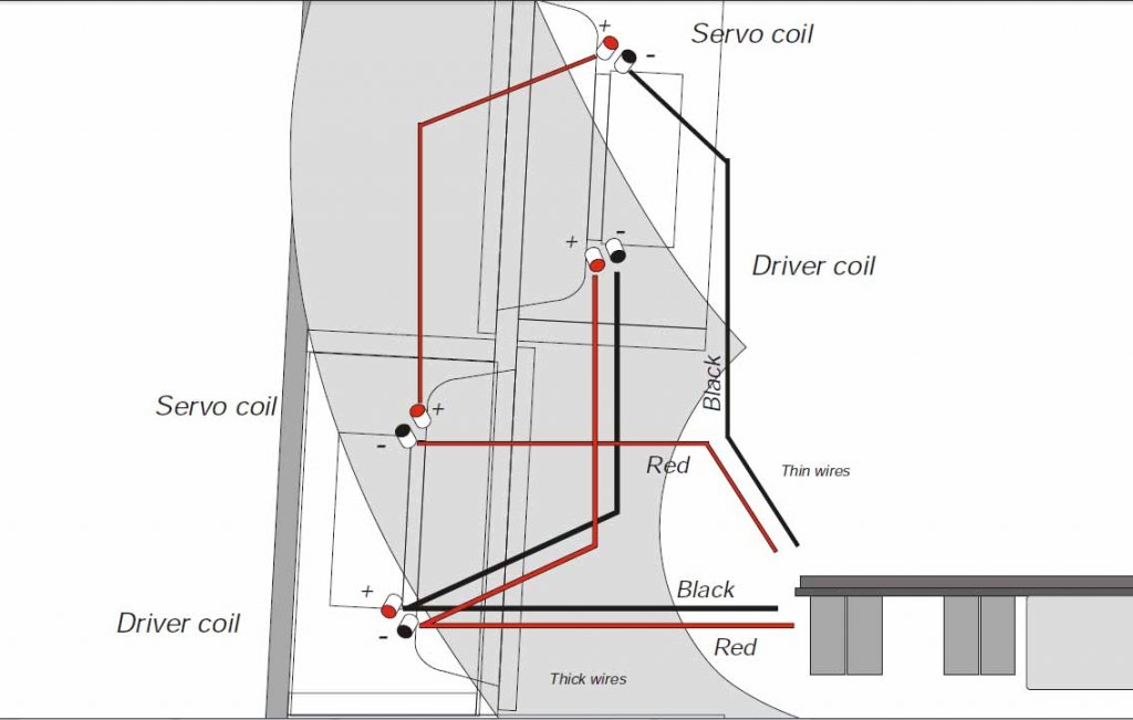

Driver coils are wired in parallel with the  rearward driver being out of phase (reversed polarity)
Servo coils are wired in series again with the reverse driver  being out of phase
The heavier wires from the amp are the driver leads, the thins are the servo leads.
Here you go, from Danny's V1's
jay

Then there is a connection (not pictured) on the side or bottom of the amp for the thin pair and thick pair?

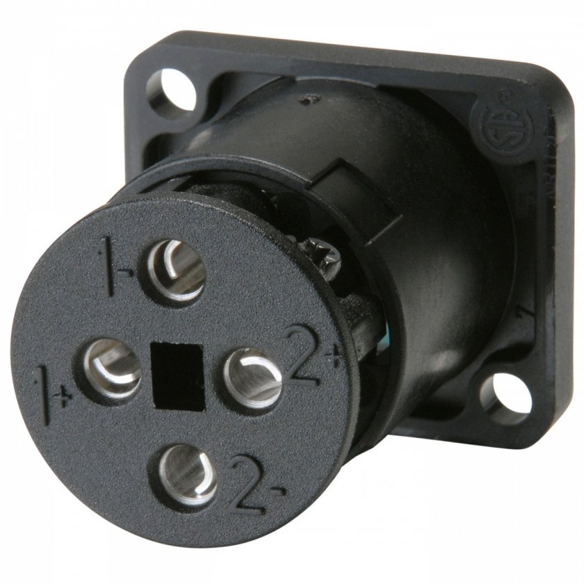

The leads  are underneath onthe open side of the amp.  If the amp is new, they'll probably be wrapped up in  two separate bunles. If I remember right, each pair will already have a connector on them, you just need to cut them off and wire them into one half of 4 pole connector  (you can get   them from Danny when  your order everythign else)

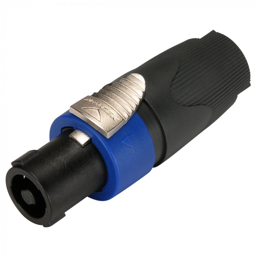

To piggy back on what Jay has said, you will use some combination of male and female Neutrik SpeakOn connectors to connect the speakers to the amp. The male connectors look like this
While the female connectors look like this

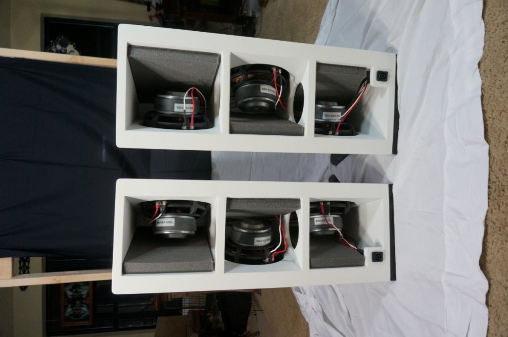

When you build the speaker cabinets you put a female connector on the inside bottom of each cabinet (these are 3x8" Wedge frames but the concept is the same for the H-Frames) I have no clue why this picture is displaying sideways.

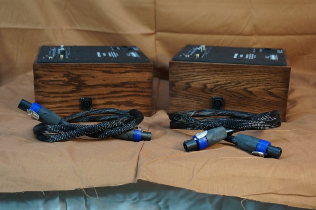

When you build the amp boxes you can either solder the speaker wires direct to the amp wires and terminate the other end with a male SpeakOn connector or you can install a female connector to the amp box just like you did on the speaker cabinet
If you put female connectors on both the speaker cabinets and the amp boxes you would need to build a speaker cable with male connectors on both ends.

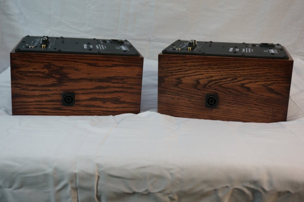

Heres a pic of the back side of the amp.
You can see the thick and thin wires.
