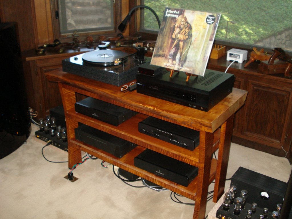

Here's one I built from 5/4 curly maple with a 3" slab of spalted curly maple for a top.  I use Herbies under the shelves and gliders under the legs.
(nothing succeeds like excess!)

I really like the designs by ACHiPo and Brooklyn.  Obviously, I'm partial to the massive, sturdy and utilitarian aspects of butcher block.  Very pleasing to my eye.
