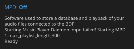

Ive done as advised and even dug a bit further: changed some user id's and pw in the Nas Share interface of MM, clicking next to save and end the procedure. Nothing visually happens though in MM, and checking my BDP, apparently it had rebooted? Is this expected behavior? The MM interface not responding or giving feedback is a bit awkward, maybe you could implement some feedback there?
BDP is still in the N fase after the reboot, and MPD is not yet responding. starting MPB in the settings page gives:
Ive checked /user/Nas, and the new shares , id's and pw's are stored correctly.
