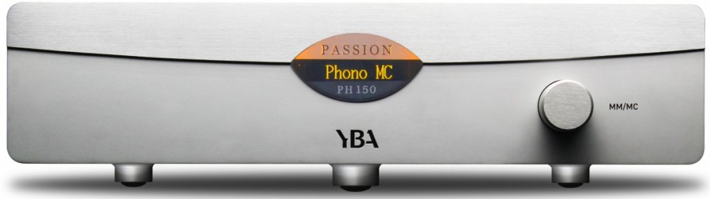

As an update, YBA is introducing the new "Passion" series Phono Stage - PH150 - for MM & MC cartridges.
Although it shares the "Passion" series faceplate & 9mm bottom plate, it is 2 separate housings - one for PS and one for signal circuitry. See attached photos.
US$ 5200
Specifications:
Input impedance                             100ohms or 47Kohms
Gain                                               MM or high MC: 40, 45dB
                                                      MC: 60dB
SNR                                                90dB (A weighted @ 40dB input gain)
THD                                                <0.005%
RIAA accuracy                                 Within 0.3dB (20Hz - 20kHz)
Outputs                                           1 RCA 1 Balanced
Inputs                                             3 RCA Analog Signal Inputs
Display                                            OLED
Display Brightness                            Adjustable from remote
Finish                                              Natural aluminium
Power Supply                                   Linear power supply with high performance transformer 190VA
Dimensions                                      430mm x 400mm x 118mm
Weight                                            11.5 kg
Jim Ricketts/tmh audio
