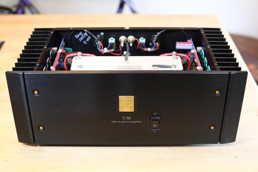

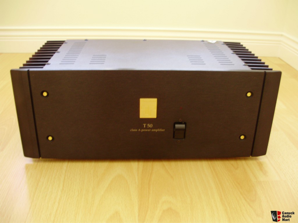

Here's some pics of the speakers I'm using (DIY) and a couple pics of the Threshold T50 AMP.
Sorry if I rambled on.
For now I can only get a stock photo of the insides until I take it apart.
