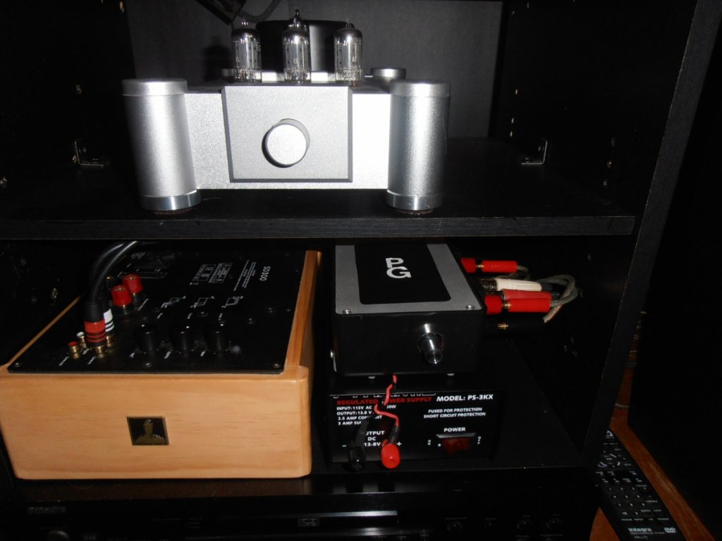

Thanks JohnR & raindance for info re: input impedance. Geddes recommends a Behringer DCX2496 loudspeaker management system coupled with rack amps/ AVR (like his older Pioneer VSX-919H with preamp outs) to handle a multi-sub system.Poultrygeist,What preamp are you using to split the single output to a pair of Y cables for splitting to amp for mains & plate amp for bucket sub pair? Your prior comments about the buckets subs really left an impression, & high on my list of considerations.

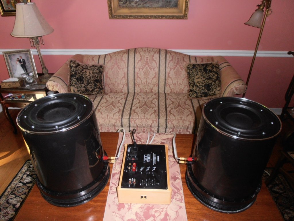

The bucket subs blend so well you don't know they're there until you turn them off.
I have more than ones done measurements with REW of some monitors and thinking it sounds pretty nice and didn't realize until I saw the frequency plots that I had forgotten to turn off the bucket subs. Once the buckets were turned-off, the sound was thin and it definitely feel like something is missing. You can't really call the bucket subs a HT subwoofer monster aimed at movies, but for music, they are great!Yes, they are ugly, but they are so small it easy to hide them, or you can do like Poultrygeist and spend a little bit extra time and make them in pianoblack and chrome. PG - do you have a picture uploaded on this forum?
