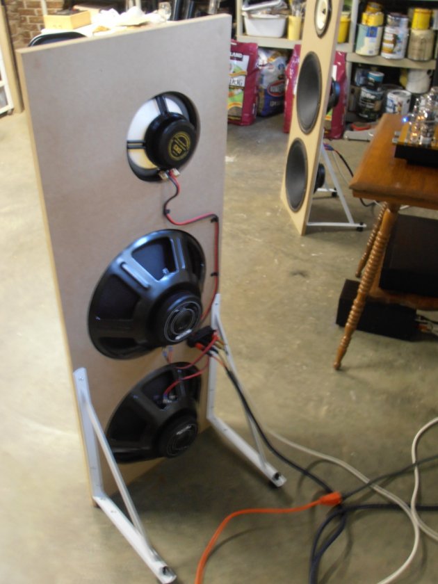

I have had personal experience with high efficiency OB (visaton b200 drivers @ 96dB) driven by an SE pentode Magnavox EL84 amp.  I absolutely loved the sound.  It was dynamic, it had detail, and it had excellent tone.
That all said, I do feel that my current setup delivers a similarly excellent presentation (Maggie 1.6QR's and a Crown XLS 1500 amp) while being at the polar opposite of the efficiency scale.
I think it is combinations of excellent gear that make for satisfying systems, and have proven (if only to me  :lol:) that it can be done at either end of small amp vs big amp.
