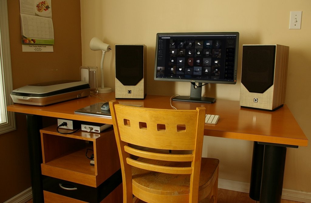

I am running Super 3is with a sub.  I've got them on a desk which I've pulled back from the wall far enough so the front of the speakers are about 32 inches from the wall.  I noticed that the soundstage definitely opens up more and provides width and depth.  My mother in law asked me, "what is doing that to the music?"  I don't follow the equilateral triangle listening suggestion, though.  My ears are about 42 inches from the center of each driver and the drivers themselves are bout 69 inches apart.  I find that this gives me a much larger soundstage with very accurate instrument positioning and separation.

I went to your "systems" picture and your rig looks really nice.  If I had the real estate, I would like to try setting up one of my systems like you've done.  On the desktop, the last system I had did it all, and the speakers were almost touching the back wall.  Image width, depth, clarity etc. were excellent and no sub was needed.  The front end in that system was extremely good.  The Temple amps I brought in didn't hang around long.  The picture makes the system look more cramped than it really was.

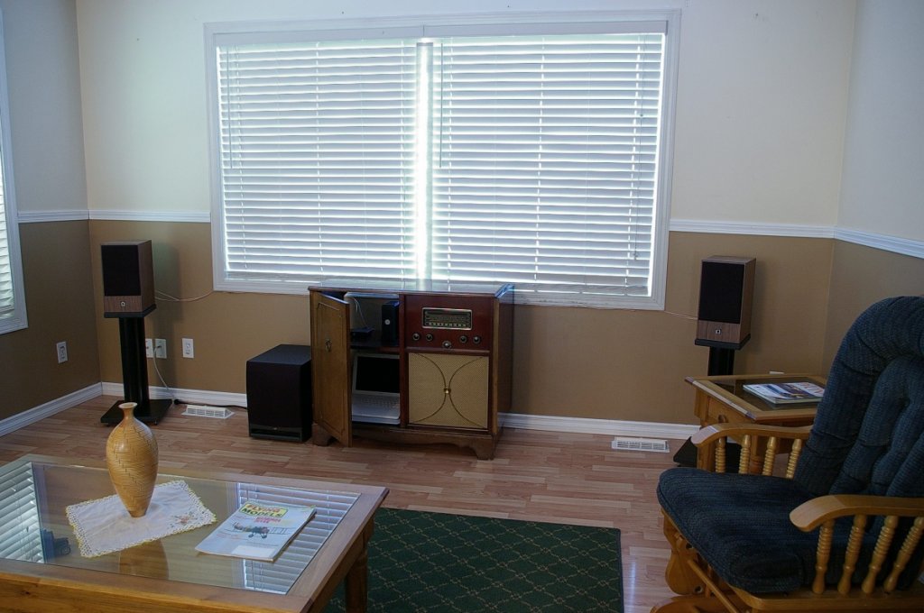

Image width, depth, and focus can also be greatly affected by upline gear (amp, source, cabling, etc.).  That said, moving the speakers out into the room will help image depth, and if you have a nice fast sub it seems like a no brainer to do so.  The picture below looks about as "non audiophile" as you can get, but even without the sub running, the Super 3i's filled the 13' x 25' room no problem with a huge soundstage.  My only criticism was the soundstage depth, though good, it could have been a little deeper, but traffic patterns kept the speakers closer to the wall for safety.  For amplifiers: in my experience, nothing images like a good SET - they're downright spooky, and I feel if a person has one they can probably get away with having their speakers closer to the wall and still have that wonderful deep soundstage - having your cake and eating it too.

I have been messing around with toe in again based upon some observations posted in another thread in this circle and have landed on very little toe in.  If you set yourself up with a desktop solution in the future, start with no toe in and go from there.  You might be able to compensate for a lack of real estate.  An unorthodox variation would be to actually pull your desk away from the wall to give your speakers some room.  I put my monitor on a separate piece of wood, counterweight it, and hang it over the back of my desk to help reduce reflections in between my 3is.  I also bought a pair of Isoacoustic stands to raise the drivers to ear height.

I hope you didn't misunderstand me.  That system was far better than any headphone outfit I've heard and I've heard some nice ones.  The picture doesn't reveal the space behind the desk or the fact that the speakers are hanging over the back of it.  That said, I'd love to do what you suggest, but I have room constraints that currently preclude that option.  The Isoacoustic stands are a great idea and I've had my eye on them for some time.  I should spring for a set.
The desk was designed and built for computer audio and has damped hidden outriggers that reach out and touch the back and side walls making the desk solid as a rock horizontally.  It also has an almost hidden damped center support.  The legs are internally damped.  This desk was designed with the same principals as my main audio rack and both have served me very well for over six years.  I would, like you suggest, like to get my desk further out, as longer outriggers are no problem.
