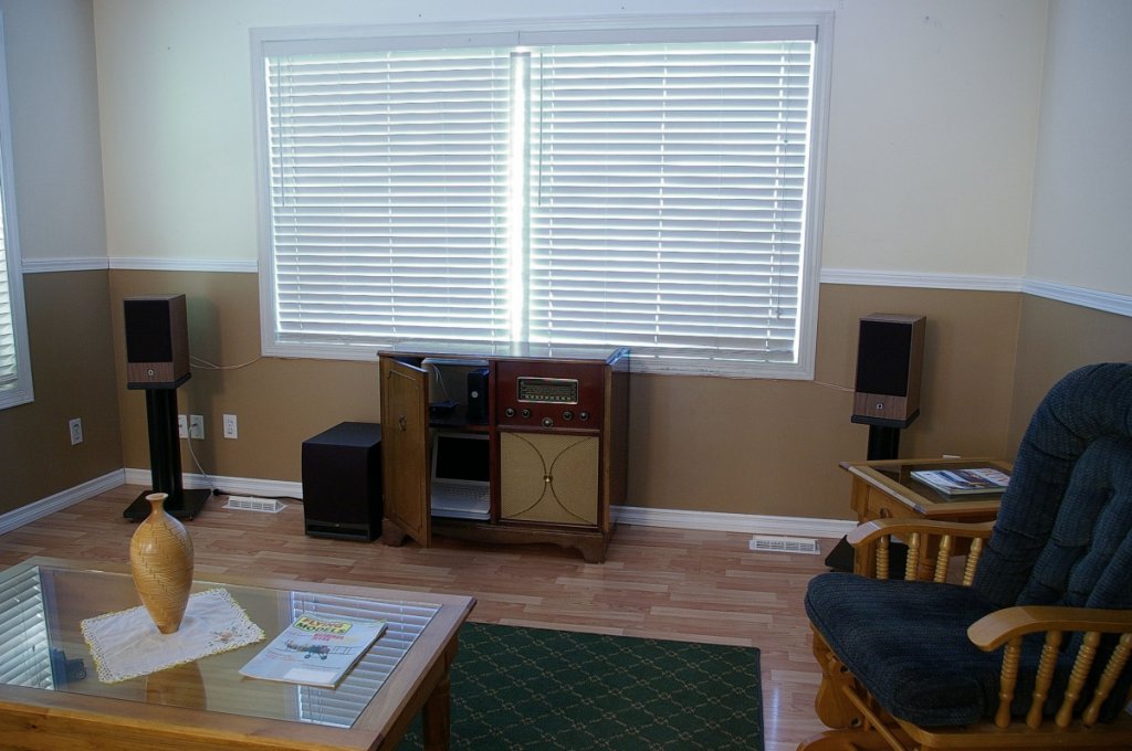

First off I realize everyone's idea of satisfying Bass can vary widely based on personal taste and music preferences. I listen to a lot of Blues, Blues Rock and Rock. My baseline (reference) for good Bass is what is typically produced by a good live band in a smallish to medium sized music venue. I go to at least 2 live shows a month. This type of Live Bass is difficult and depending on the listening room sometimes impossible to reproduce in a home environment.
I ran Klipsch RF-7 towers for a long time. Placed 4 feet out from the front wall they produced a very wide & deep soundstage but lacked Bass punch. If I slid them up to within 2 feet of the front wall Bass really started to come alive but the width & depth of the soundstage started to collapse. So my preferred compromise was to place them 4 feet off the front wall. About 4 years ago I purchased twin Mid Bass Modules (operating from 150 to 50 Hz) and twin Subs (operating from 50 Hz and down). As you will see from the photos I now have Omega Alnico Monitors.
So I've had full range floor standers and now Monitors. My current set-up with Monitors and subs are my preferred arrangement for these reasons. The monitors are faster and easier to place where they image best without worrying about Bass reproduction. The Subs can be placed where they produce the best quality Bass while at the same time enhancing the imaging and soundstage of the Monitors.
If not done correctly, adding a Sub can actually sound like Crap. First thing is if you get any Sub hum then you have a ground loop or a sub issue that must be resolved. So assuming you have no Sub Hum the next step is to connect your sub via speaker level (speaker wires). This way the Monitors and Sub are reproducing the same amp signature. I'm sure there are exceptions but in my case speaker level connections to the Sub have always provided a seamless integration between Sub and Monitors. Each time I have tried Line Level connections (interconnects) to the Sub with various amps it is just too often that you can hear the Sub separately from the Monitors.
Next step is to do everything possible to disperse the Sub's energy evenly out into the listen space to avoid unnecessarily exciting the floor and walls. A downward firing Sub will quickly cause the floor to vibrate and transfer that vibration to the walls. Vibrating floor and or walls will quickly muddy the Bass at the listening position. I have found Sub isolation platforms from Auralex to be effective. They prevent cabinet vibrations from my forward firing 15" Subs from being transferred into the floor. They also act to dissipate the Bass energy from my downward firing Mid Bass Modules out into the listening space rather than directly into the floor.
In the lower photo you will see that the Mid Bass Module is a good foot off the front wall. I found that any closer to the front wall would cause the wall to vibrate and this would muddy up the Bass considerably at the listening position (sound like crap). So the bottom line is you don't want to be listening to your Sub hum or room surfaces vibrate (these were not on the original recording). If I were purchasing a Music Sub today, it would definitely be the DeepOmega 12 because of it's speed and ability to play well up into the 150 Hz range for added Mid Bass Punch.
So my point here is that Monitor's properly integrated with the right Sub can sound wonderful. But as someone I used to know would say "It's not as easy as falling off a log".

Thanks!  So your take is that if one has subs, then no reason to go with XRS?  Nice setup by the way.

Looks like he's running an Oppo 105 with a Decware Zen. Should be a very nice sounding setup. Room looks fairly large and a bit live, which can shift tonality at the listening seat a lot (compared to your setup, Rob). It could also be that DBC prefers a bigger midbass presentation. For the music he enjoys and experiences at concerts, recreating what he hears at these concerts is his goal. Could dialing-in his system to mimic these concerts skew the presentation of other recordings / music types? Yes. I think that's very possible.
When I first got my Super Alnico Monitors I set them up upstairs in an acoustically live room on the short wall of a 13' X 25' room that opens out into a stairwell and hall at the opposite end.  I had them on 24" stands (I didn't have my Skylans then) hooked up to a solid state amp.  The results were the same - warm, full, and rich, yet not lacking in detail.  The Alnicos were set up in the place of the Super 3i in this picture.  Not that far off DBCs venue as far as I can tell.  All I'm saying, is the native sound signature of this speaker is not lean and dry.
