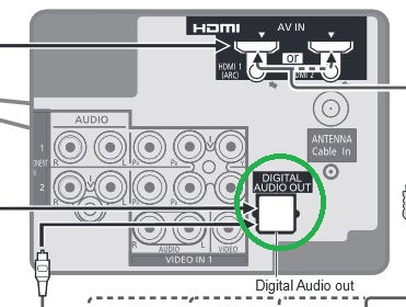

srb
Re: HDMI Audio Extractors
« Reply #6 on: 3 Jul 2015, 09:53 pm »
WRT the bolded part, if my TV had an audio output I'd have more options but to my surprise the TV has no outputs whatsoever...  :duh:
I guess I may have been looking at the wrong TV manual - I was looking at the TC-P58S2.
Most Panasonic TVs don't have analog audio outputs, but yours would be the first one I've ever seen without a digital audio optical output.  (Are you sure?)
Steve

« Reply #7 on: 3 Jul 2015, 10:23 pm »
Yup, it's there... I thought I looked around thoroughly, I have no idea how I missed it!  :oops:
The Fiio looks like a better option for sure, thanks!
« Reply #8 on: 3 Jul 2015, 10:25 pm »
It would be very easy to miss if it wasn't labeled  ;) , as in less than perfect lighting the little black plastic square jack disappears against a black background.  The black plastic spring-loaded cover "door" pivots out of the way when a TOSLINK connector is inserted.
