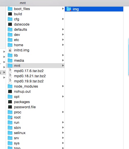

What's your experience with replay gain, does it work as you'd expect it to? Do you have all music played evenly?
Ive been trying to enter the .mnt/img folders, supposedly in developer-mode, but am locked out, how did you manage to get in?

Hi
I am on Windows and use WinSCP to connect to BDP, login as root

Manic Moose now creates a samba share called "user" that takes you to /mnt/img now
Marius
Re: BDP-1 - the problems just keep multiplying
« Reply #19 on: 1 Jul 2015, 08:14 pm »
Great, played around with the /user already, just didn't realize  it was an exact copy. So much better indeed, no more poking around in the system files, but just an easily available folder.
Thanks Chris, wonderful solution!
