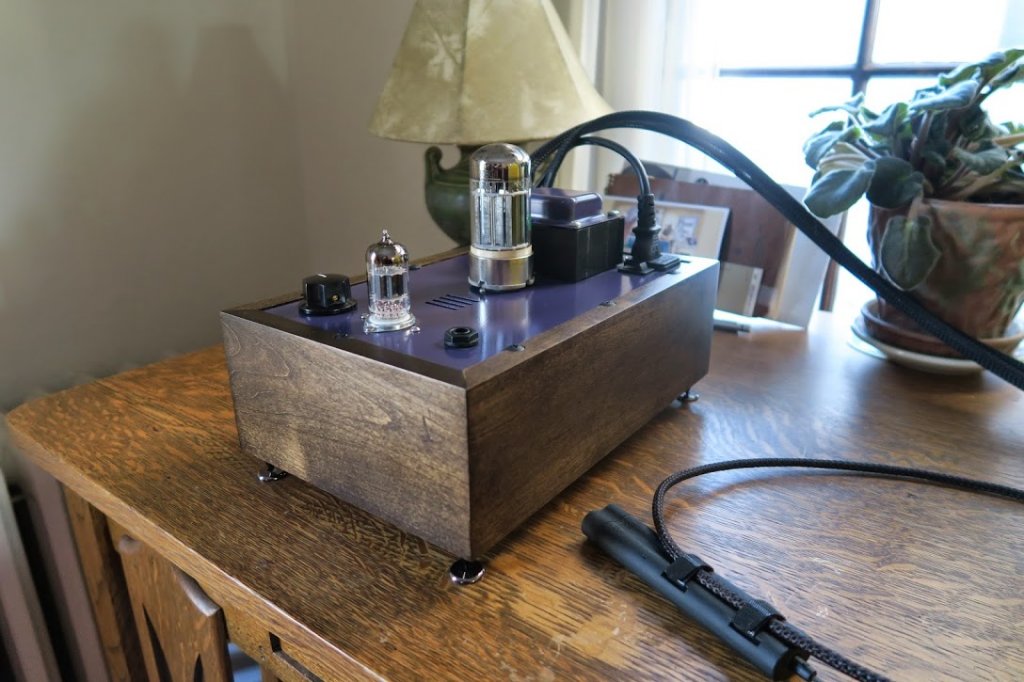

OK I just finished the basic Bottlehead Crack project and finished the wooden enclosure.
I used a Dark Mission Oak Minwax stain, 4 coats sanded in between and it came out nice.
I also added 4 resistors in a voltage divider arrangemment in the RCA inputs and across the 100k volume pots. This mod is described
on the BH Crack forum FAQ's. Some people depending on the impeadance of the headphones and how hot source material is can only turn the
volume control a small amount, this makes this issue go away.....I can fully utilize the vol pot now, away from low settings where channel imbalances are noticeable.
Here's some pix of it and the Beyer T90's. Its a really nice solution for listening to music with these cans!!
PIX:
Alex......whats next install the Speedball Upgrade when it come in...a constant current source to make things even better!

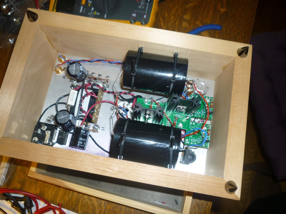

Ok Update ...I just added the Speedball upgrade to the Bottlhead Crack...
What is that you ask?
Well here is BH's explanation:
“A Camille Cascode Constant Current Source is applied to each triode—both halves of the 12AU7 voltage amplifiers and both halves of the 6080 cathode followers. By loading a triode voltage amplifier with a high impedance, such as an active current source, it operates in a more linear region and produces less distortion. A second advantage, not as widely appreciated, is that the current source provides a great deal of isolation from the power supply. A good current source will provide a high impedance over a wide range of frequencies including radio frequency interference. It is otherwise extremely difficult to stop RFI that is carried on the power line, because power supply chokes have a leakage capacitance and the large capacitors used will also have some inductance at high frequencies. Isolation from the power supply also removes the power supply capacitors from the signal current loop.”
Here is what it looks like:
Its three small PCB's with a dozen or so parts, resistors, Led diodes, transistors etc...
There was a $20 upgrade deal last month and I bought the kit.
It took me about 2.5 hours or so to populate and wire it in.
Fairly easy to do if you know how to solder etc...common sense.
All voltages checked out the first time and it played very well from the get go.
With my BeyerDynamic T-90's the spound is SUPERB....I cant imagine it getting it any better.
Totally black silent background, awesome soundstage, detail etc...all those superlatives..the kick drum is so dang good, taunt, deep etc..
The problem is now I will spend way too much time re-listening to all my music again...and thats fine with me!!!
Alex
