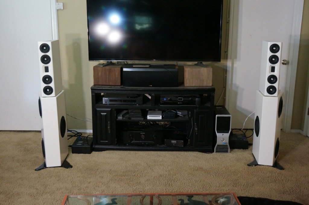

After I finished the new Wedgies, I set the whole system up in the larger living room (my wife is out of town until tomorrow night). I pulled them out until the center of the bass woofers was 3ft from the wall (back of cabinet 32” from the wall).
When I started playing the Wedges in this position I heard the same things I did upstairs. Also, the sound stage was much wider but more unfocused, almost like an echo but not quite and the chest thump from the bass was more pronounced.

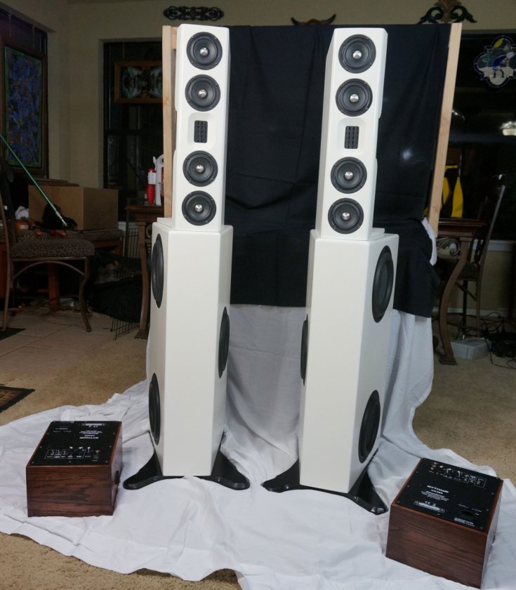

If you look at the picture of the system setup you might see what was happening.
I thought all those doors behind the speakers provided a highly reflective surface which was causing the ehco/smearing I was hearing. Unfortunately, I do not have any sound absorption panels but I do have some moving blankets. I took four of the large blankets, folded each one in half to provide a double layer of heavy material and hung them up behind the speakers.
That did the trick. The sound stage cleaned up, focused and the echo/smearing went away. So did the chest thump from the bass units. Now they played deep, clean and open. The bass is still authoritative but it no longer loads the room. To me it seems like the best of both worlds, clean open baffle bass with just the tiniest hint of subwoofer thump and then only on extremely bass heavy tracks that were intended to have the thump such as the Telarc recording of the 1812 Overture when the cannons fire.  Deep musical bass is just that, deep and musical yet open and spacious.

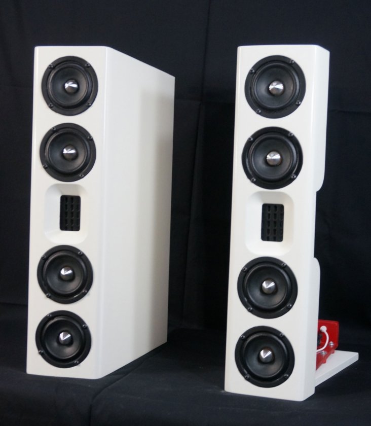

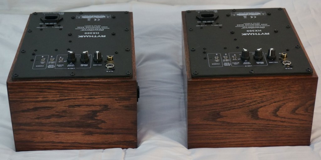

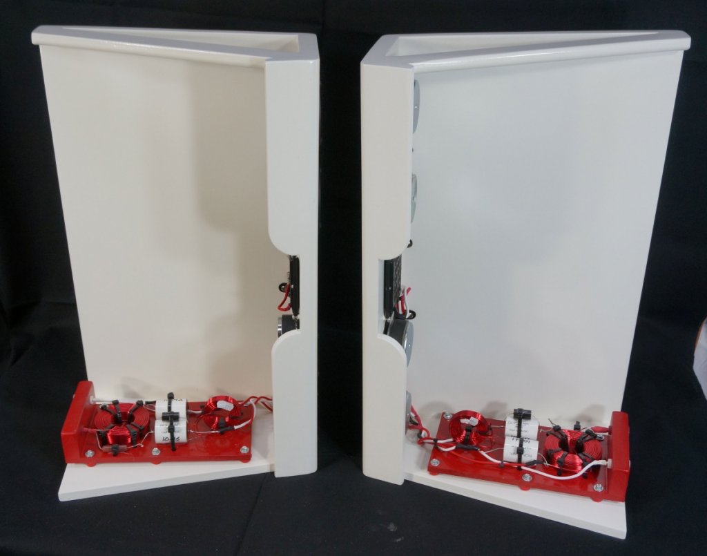

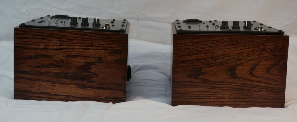

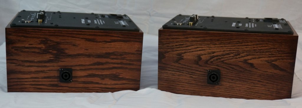

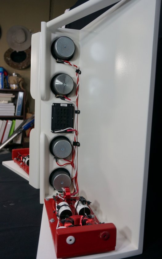

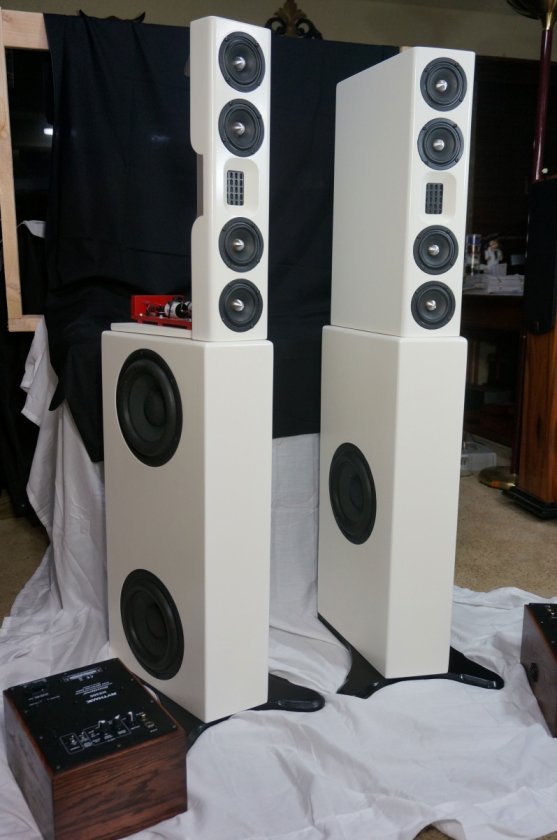

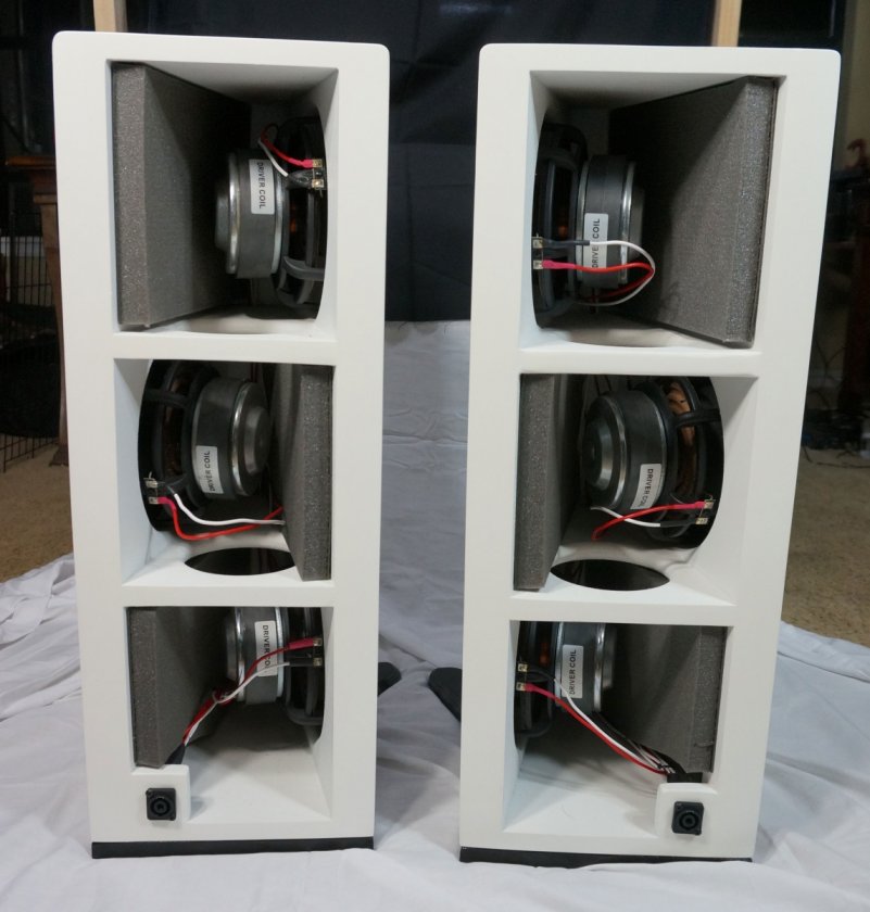

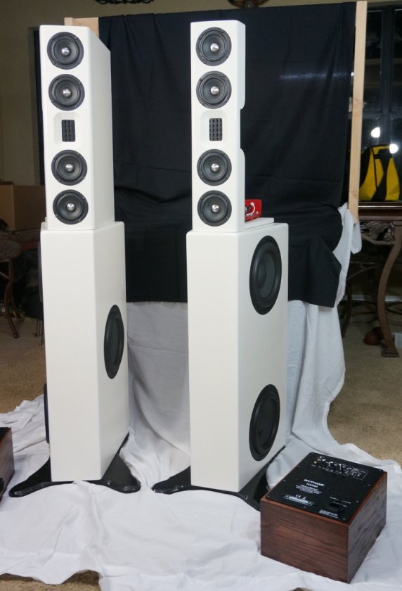

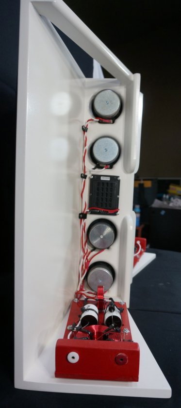

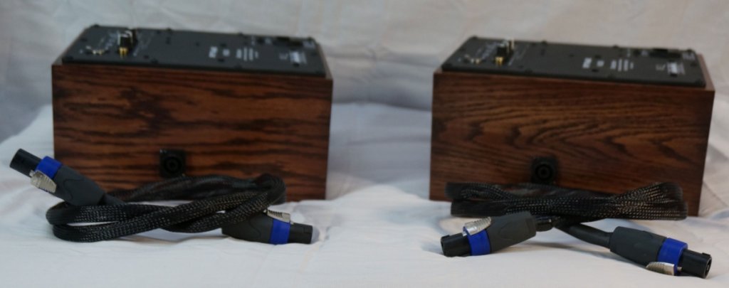

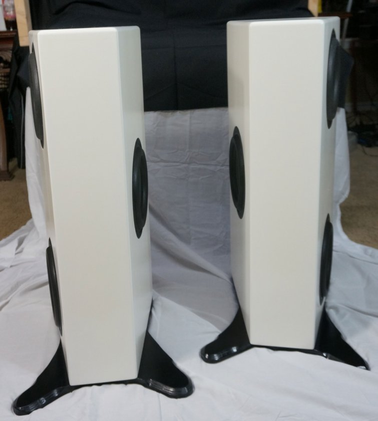

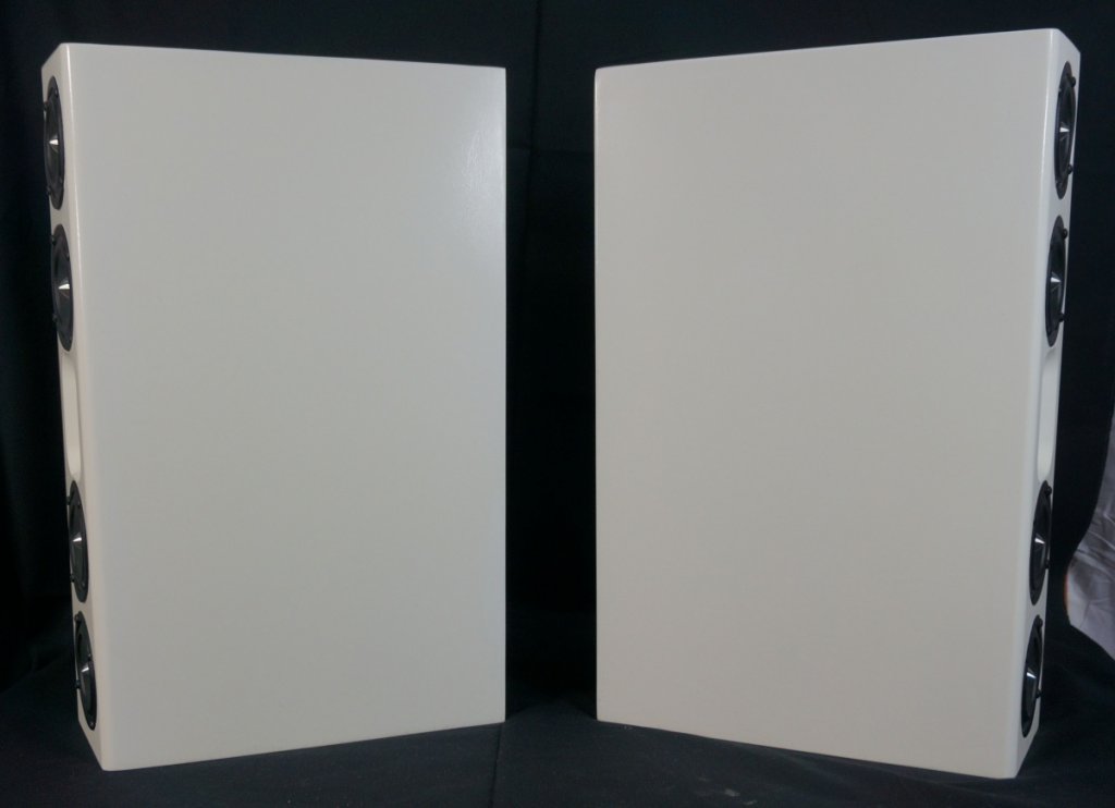

Finally, they're done. I finished the amp boxes earlier this week. Here are some final pics. First the amp boxes:
Next some of the Wedgies:

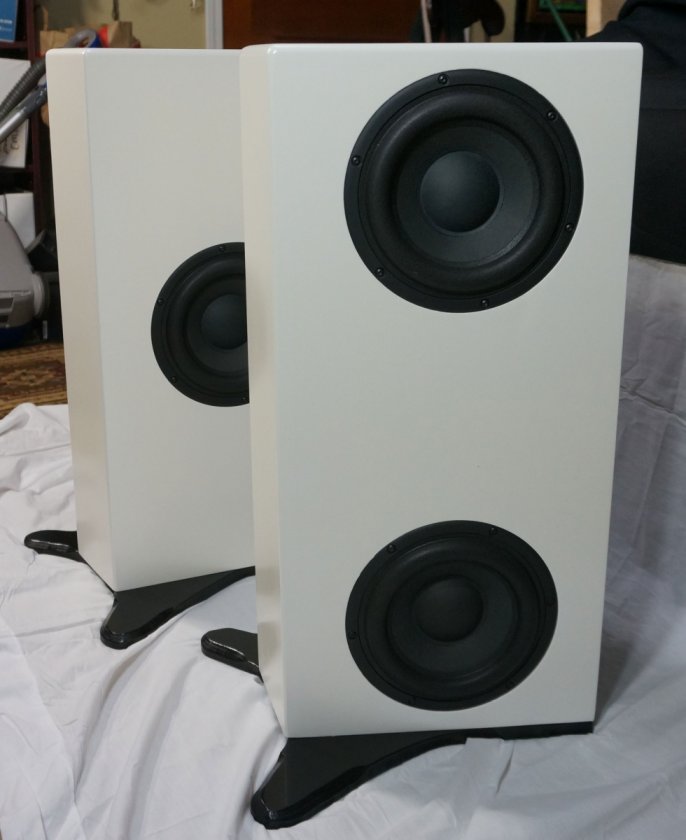

Here's some of the Wedge Bass units:
And here they are all together:
It has taken 3 months but tomorrow I'll be delivering them to their new home in Fayetteville, AR
