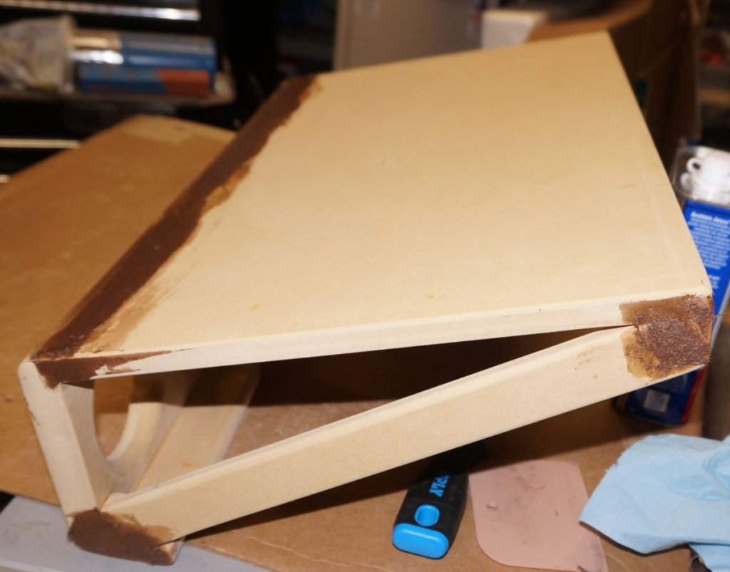

Since these speakers are going to be painted, once they were glued up I needed to stabilize the seams so they won't show through the paint. To do this, I cut a groove along each seam then filled this with Bondo glass which is a fiberglass reinforced Bondo.  Due to the shape of the Wedges and already having the front edges rounded over I didn't want to try using a router to cut the grooves. So instead, I used handheld wood carving tools to gouge out the grooves then sanded them with 80 grit paper to feather the edges and rough up a surface for the Bondo to bind to.
Then I applied the Bondo glass

I discovered that Bondo makes a 'Wood Filler' version. Have you ever used it?
Steve
