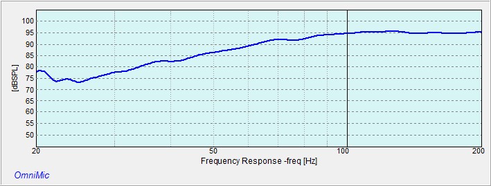

Before...
After...
This the Gamechanger line array.

Is that an OB? Never mind. Now I see that it is the Gamechanger, which is a sealed box.
 :green:
I'm not sure if I could apply enough EQ to get that response with these woofers in a dipole.  :D

I was just looking at the slope of the top curve.

The other beauty of DSP is that if you get the standard 6db of room gain in the low frequencies, you can back off the bass boost a bit and dial the speaker in to the room.
