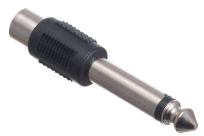

The inputs, are 1/4" TS and XLR connectors.
You can use a mono 1/4" to RCA adapter to use the TS input as single ended.   Then you just need a stereo RCA line level output connectors from a soundcard to drive both speakers via a software volume control.

The Yamaha HTR-5140 has no L/R preamp outputs, only a subwoofer output, so you won't be able to use them with that.
But they will make very nice computer monitors.  Sometimes the 1/4" input on studio type monitors is also a balanced connection for a TRS balanced phone plug, but the MSP5's 1/4" input is unbalanced and you are good to go with the mono 1/4" male plug to RCA female adapter as HAL suggested.
