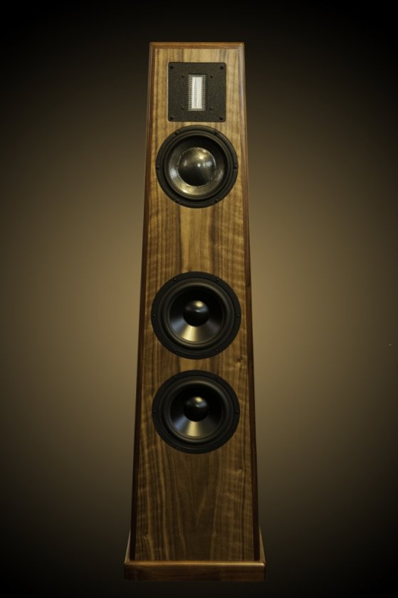

Named to honor the new owner's sister Jacquelyn who lost her life earlier this year to breast cancer.
Here's one of the initial measurements, the nearfield of the woofers which are 7" drivers in a sealed box. Very nice bass extension plus easily augmented with a subwoofer due to less phase shift than a ported or TL design. The upper end response is where the crossover is transitioning to the Morel Supreme carbon fiber midrange (titanium former version).
