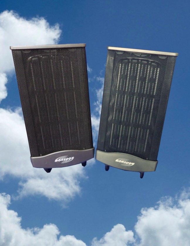

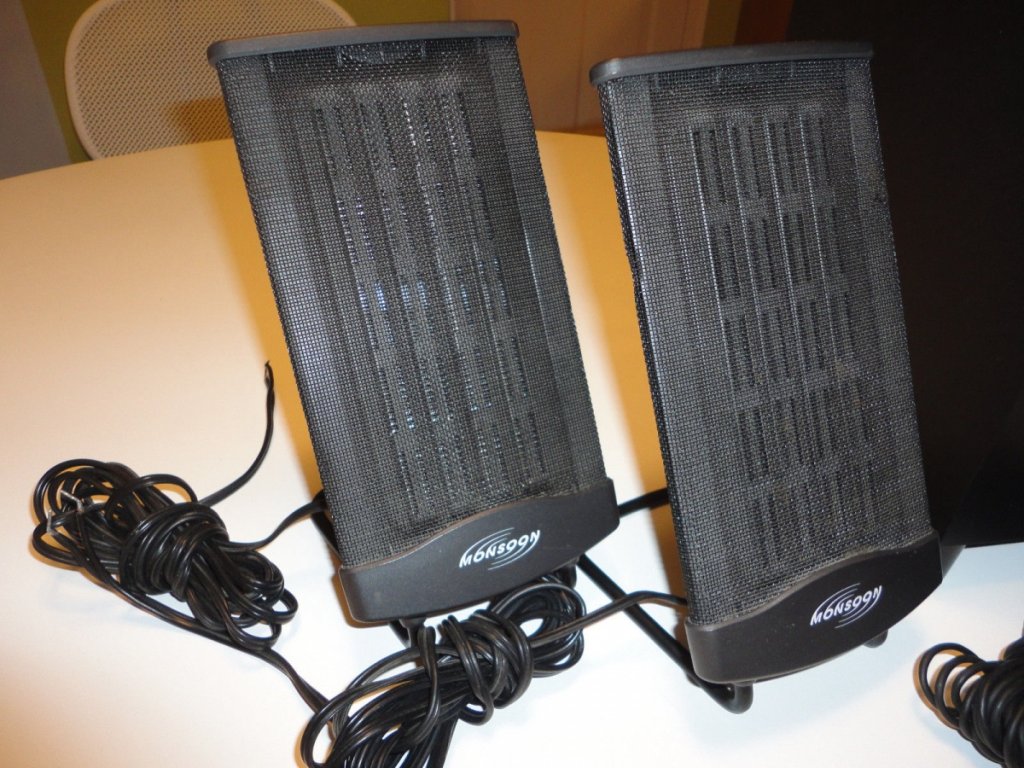

These aren't mine,  and I'm not trying to hurt any deal between the OP and HAL; just trying to help out.  But, these should be the correct RM30 mids, as long as the impedance is in the 6 ohm range (maybe email and ask).
http://www.ebay.com/itm/Rob-Pruitts-Flea-Market-VINTAGE-Monsoon-MM-700-Computer-SPEAKERS-SET-/131480563516?pt=LH_DefaultDomain_0&hash=item1e9cda2f3c
The correct 6 ohm panel had the 'curvy' edges, with 13 slots across the mid.  The 'other', straight-edged version, had 8 slots, and measured around 3 ohms.
Good luck!
Stimpy
  • Posts: 1222
Re: Any Replacement Neo Panels Available?
« Reply #3 on: 4 May 2015, 03:14 pm »
Now that I think about it, if the ebay seller that I previously linked, is selling MM-700 mids, then that is not the correct mid.  His picture is incorrect too, since it is NOT a MM-700 mid.  The ebay seller evidently just used a generic web picture in their auction.  Sorry.
Search ebay in both the 'Consumer Electronics', and 'Computer' categories, for Monsoon speakers.  You'd need to look for Monsoon MM-702 mids.  Plus, some of the Monsoon MM-2000 mids were the later 6 ohm mids; but not all.  Again, look for mids with 13 membrane slots.  Those are the mids that Brian modified and used in the RM series.
