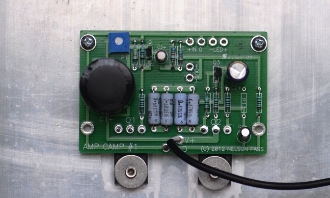

Re: Going to bother you. Inline xo
« Reply #3 on: 1 May 2015, 06:59 am »
So why is NP telling me 4.7.  Because of the internal parts?
That would be my guess.
I looked at the ACA schematic and the input is a little different
since he incorporates feedback right at the input of the amp via
R12. C3 could also figure into this.
I'm not an amp specialist but that's my guess.
Your question of why the 4.7 is a legitimate follow on question and
I think it would be reasonable to ask NP for further expansion
(if he is so inclined).

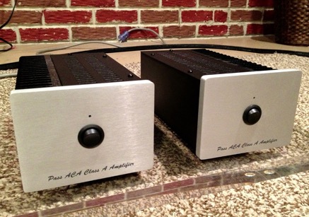

Nick,
Its just the little 6 watt Amp Camp Amp that he put together and DIY did a mono block kit.
With that said, I have, with hesitation, emailed him.  I continue to get HAL's figure from his formula and others.  I am guessing that i did not articulate myself well enough and he may have thought i was putting it on the inside or other?

rak313
« Reply #9 on: 1 May 2015, 05:47 pm »
ACA = Amp Camp Amp
I cant be sure but i thinkthis amp has again of 68/10 and has a virtual gnd after the 10k resister. So 10k is the resistance to use.  Then as was indicated before 1/RC=2•PI•F
