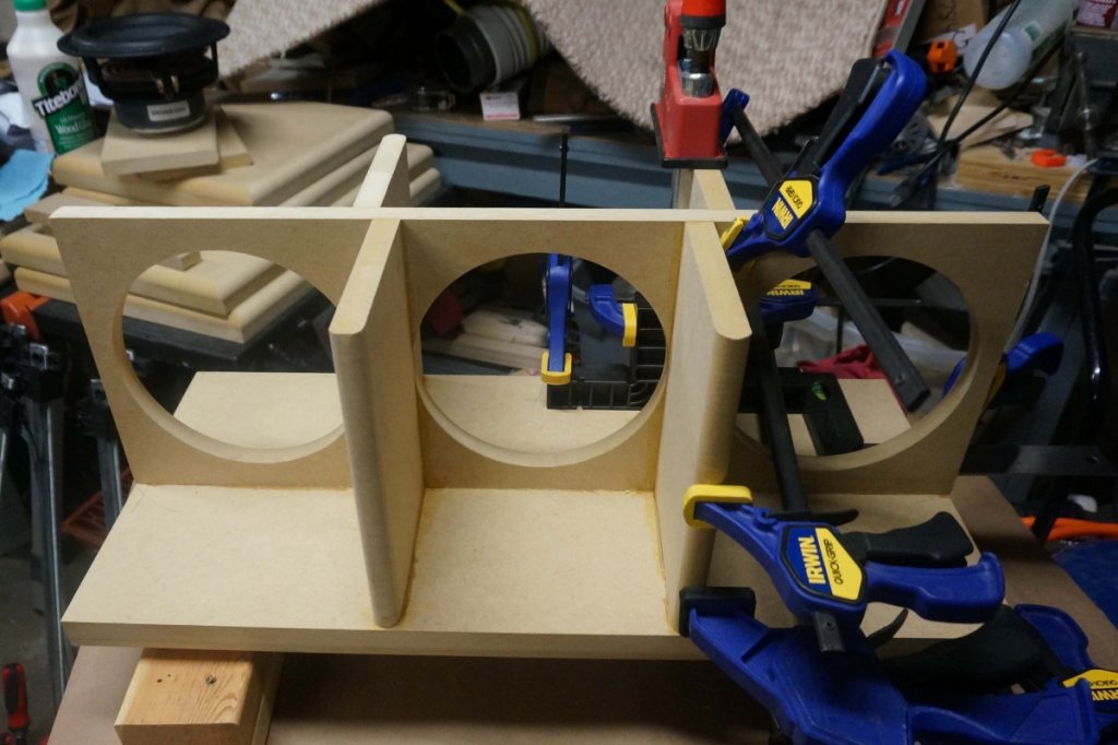

mlundy57
  • Posts: 3643
Re: DuraTex Question
« Reply #13 on: 25 Apr 2015, 03:49 pm »
Just curious Mike, how did you align everything ?  Dowels ?
As you know, I used  Dados when I built mine but  no one else seems to do that, wondering why ?
jay
Jay,
I did it the old fashioned way: layout lines, squaring jigs to keep things square vertically, a square clamped down to keep things parallel and square horizontally, cross squaring and then the inevitable sanding when things don't end up perfectly flat and level. You can see the squaring jigs and square (has the green bubble level) on the back side of the baffle.
I have used both dowels and biscuits in the past. Dowels can be really hard to line up and biscuits didn't seem to be worth the trouble. Dados would be a lot easier but not only do I not own a dado stack, I have never used one before. A good stack is on my list though.
Mike

  • Posts: 3238
  • Washington State
« Reply #14 on: 25 Apr 2015, 04:05 pm »
A router cuts nice clean dadoes.
