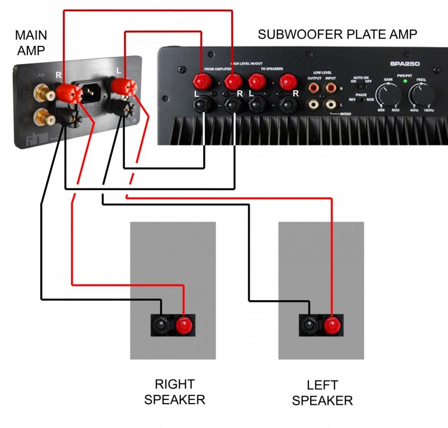

Admittedly not the best picture, but this is how to hook up a sub in a music system if you aren't using a pre-amp that cuts the low frequency to the main amp.  The sub is only taking signal off the amp and the amp sees no additional load from the sub.
When running speaker level connection, I never daisy chain from amp to sub to speakers

Not the best photo but I think you will get the meaning. Top far left are the Speaker Level input terminals for Left & Right input channels (labeled "FROM AMPLIFIER"). If you have a single Sub then run speaker connections from the Left & Right speaker output channels of your amp to the Left & Right Speaker Level input terminals on the sub. The two signals (Left & Right) will be Summed.
In my case I have twin Subs so I simply run the amps Left speaker output channel to the Left Sub and the Right speaker output channel to the Right Sub.

How does Louis set up the Outlaws?  From the pics it seems as if he uses jumpers from the speaker's main terminals (speaker level inputs) to the plate amp, is that correct?  This way you can run the main drivers full range and adjust the sub output to your liking?
That's correct. In my case I have twin subs sitting next to my mains. I run my favorite speaker cables to the Mains and tap off the main speaker input terminals as shown here and then just a short run to the sub amp. So you can run from your amp to a sub or from your mains to the sub depending on which is more convenient.
