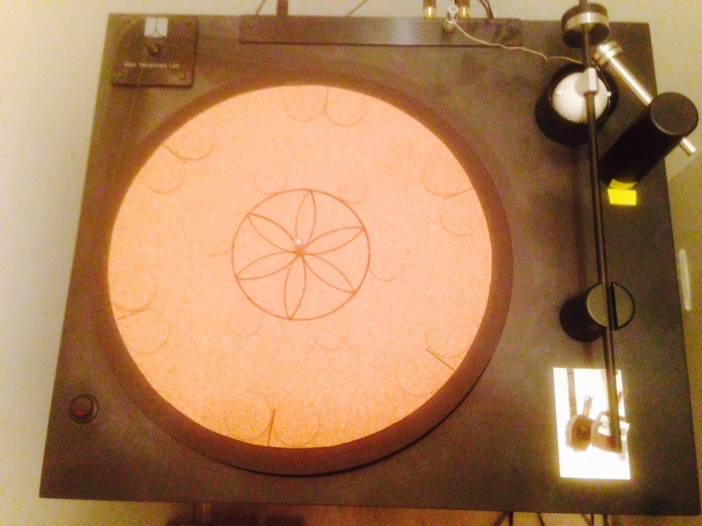

This is a cork mat I made to replace the foam original.  Lots of detail and air but never harsh.  The geometric designs were created with a compass when I was laying out the lines to line up the "pepperoni slices".  The cork is 3/32" thick, so effective height is 3/16" inch.  I keep the old foam mat on it when not in use to act as a dust cover.
The yellow tape provides markers for my starting point when I decide to tinker with geometry of the tone arm.  I usually end up right back where I started.

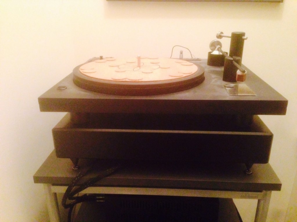

And here is my answer to the question that has not been asked: "What does one do with a left over amp stand?"  This makes a dandy turntable stand.  The bass tightened up a bit and the neighbor who helped jockey components thinks it improved PRAT slightly.

So from the second photo, are the pepperoni slices raised or attached to the mat? Hence the entire mat is or isn't in contact with a record?
I dunno... looks a little dicey, or slicy, in this case..
I've never heard a cork mat sound harsh. Dead, dull, and lifeless, yes, but never harsh.
I'd love to hear it, though. Could be a breakthrough product. Carry on...

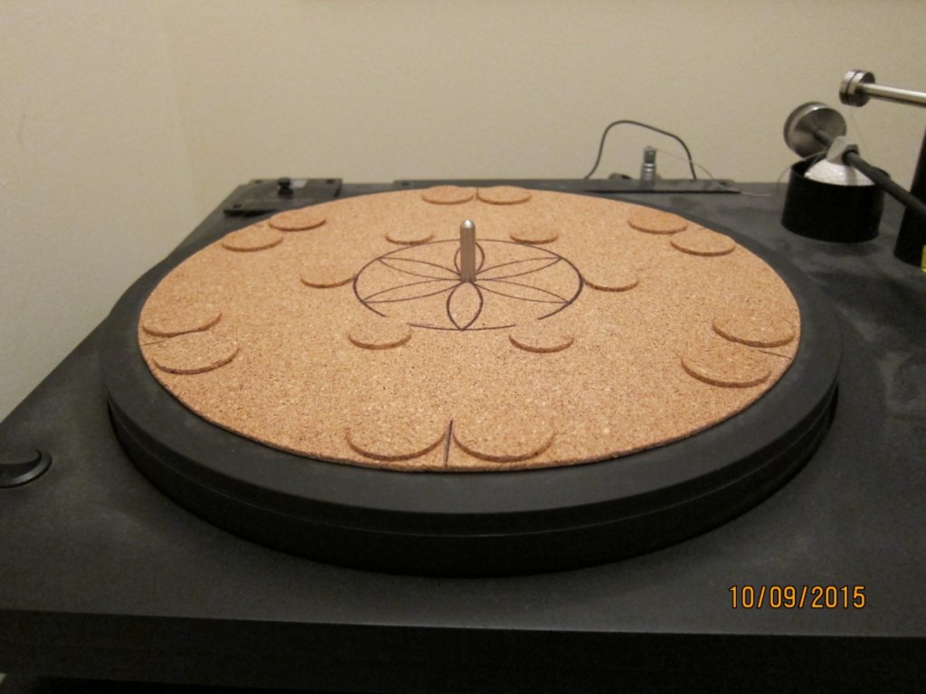

Here is a better pic from one of my real cameras
The "pepperoni" discs are attached to the mat - I think I used Titebond II glue.  The record rests on the discs and not on the mat itself.
The raised discs idea came from some research I did on DIY mats.  Pairing them was my idea, mainly so that I could space them more precisely along the circumference, but I also thought it looked cool.  Note the lines betwixt each pair, they are an extension of the line formed by the intersection points of the arcs in the center circle.  This means the mat should be well balanced.
