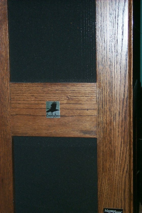

That's a view of a hardwood frame which houses an MMG panel that straddles (no physical contact) an REL Q150 sub. I love the combination. I love the combination in this arrangement even more.  :D
