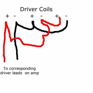

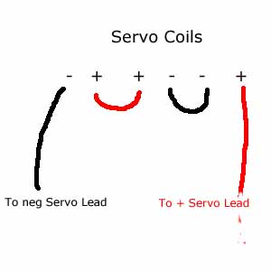

Re: HX300 Question
« Reply #3 on: 19 Apr 2015, 09:21 pm »
Mike, it's the same as the diagram but wire the  top one the same as the bottom one.
So,  bottom and top  are   inphase, middle is out of phase.
Just remember to keep the driver coils in parallel, the  servo coils in series....  .   so the terminals of the  center servo coil should go to  the same terminal of the top/bottom  servo  coil (+->+ , - -> -).   Then the unused  terminals of the top/bottom servo coil will go to the  matching   servo leads from the amp keeping  them in phase...The middle  driver coil is  just simply reversed polarity (all driver coils in parallel) .
LOL, hope that made sense
rough, but you get the idea
jay

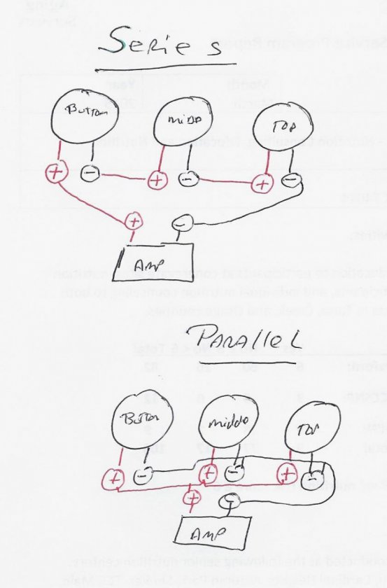

Jay,
I'm confused. I thought series was: positive to negative,
+ amp -> + speaker 1, - speaker 1 -> + speaker 2, - speaker 2 -> + speaker 3, - speaker 3 -> - amp
and parallel was positive to positive and negative to negative:
+ amp -> + speaker 1 -> + speaker 2 -> + speaker 3  then
- amp -> - speaker 1 -> - speaker 2 -> - speaker 3
This looks very different from what you drew. This stuff is definitely not my strong suit  :scratch:
Mike
Re: HX300 Question
« Reply #5 on: 19 Apr 2015, 10:23 pm »
the middle driver (opposite facing) has to be out of phase on both the  driver coil and servo coil.
so as yo wrote it (altered )
series (servo):
+ amp -> + speaker 1, - speaker 1 -> - speaker 2, + speaker 2 -> + speaker 3, - speaker 3 -> - amp  (still in series but middle one out of phase)
+ amp -> + speaker 1 -> - speaker 2 -> + speaker 3  then
- amp -> - speaker 1 -> + speaker 2 -> - speaker 3  (still in parallel but middle out of phase)
jay

Re: HX300 Question
« Reply #14 on: 19 Apr 2015, 11:53 pm »
just like my crude diagrams above  :lol: (assuming  left side is botom)
jay

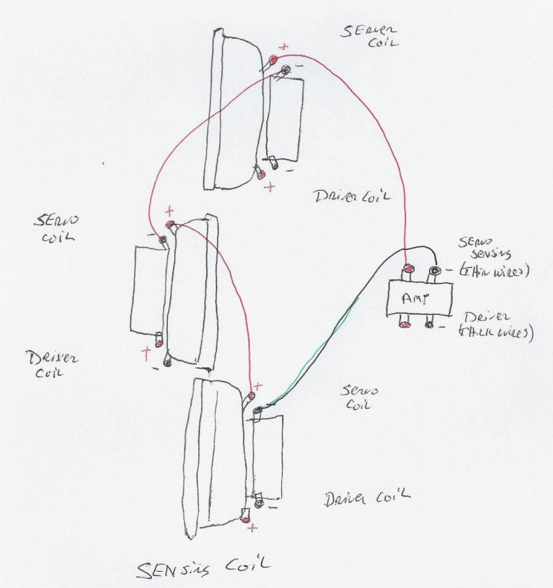

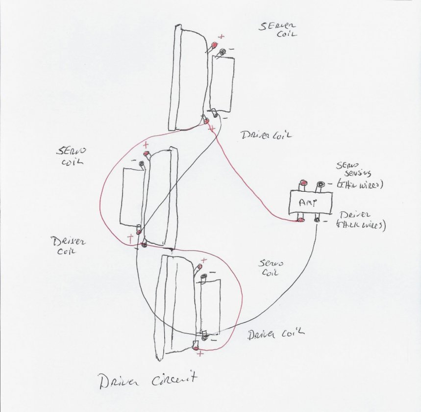

mlundy57
  • Posts: 3643
Re: HX300 Question
« Reply #15 on: 20 Apr 2015, 12:13 am »
I think I have it. The servo sensing circuit would look like this:
and the driver circuit would look like this
Have I got it?
Mike
HAL
  • Industry Contributor
  • Posts: 5588
Re: HX300 Question
  • Posts: 5588
Re: HX300 Question
« Reply #17 on: 20 Apr 2015, 12:14 am »
Mike,
That is correct.
