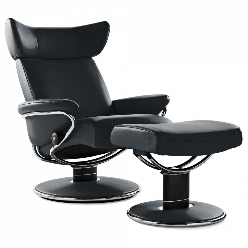

Just get a chair with a higher leather headrest.
The Ikea Poang chair I have actually came with a leather headrest.  The chair I was using before I got the Poang had nothing behind the head at all and the first time I heard music while sitting in the Poang I was not happy with its sonic contribution.  I immediately removed the padded leather headrest and "ahhhh....much better".  The highest point on the wood frame of the Poang is about even with the base of my skull, so there is nothing directly behind my ears with the headrest removed.
tomlinmgt
  • Posts: 159
I understand the logic behind the "chair with headrest" suggestion you guys are making, but that's not the solution for me.  I don't much care for the effect of having the solid, reflective surface right behind my head/ears.  My friend has one of Ekornes Stressless chairs and although the thing is insanely comfortable I think it sucks for critical listening.
The thing that's going on when I'm doing the hands behind the head thing is my arms create reflective surfaces to either side of my head that scatter sonic energy rather than create a solid boundary layer directly behind my head/ears which would return all sonic content that passes by my head.  Big difference, I think.
Anyway, hearing the results of this has made me second guess having total absorption behind me.
