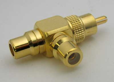

Or...Best to use one (two)of these, either as a splitter or daisy chained off the BHA-1 or the transmitter.
