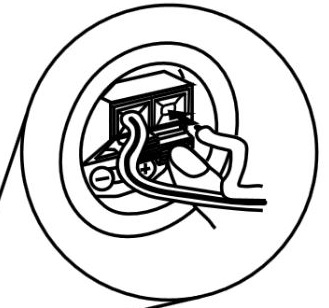

Sound Appeal SA-VF6.5S Bookshelf Speakers
Could you verify whether the rear speaker connectors are binding posts or spring clips?
I couldn't find a photo or description, but the owner's manual says "Strip off 1/2” of insulation from the ends of the cable, twist the bare strands and insert into the binding post" while the generic line drawing appears to show a spring clip.
Steve
They are push-pin spring clip connectors - they will take heavy gauge wire or pin connectors.
