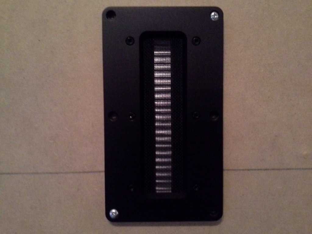

Greetings,
I have begun my OB project.  I'm in the "Frankenstein" phase right now. :thumb:

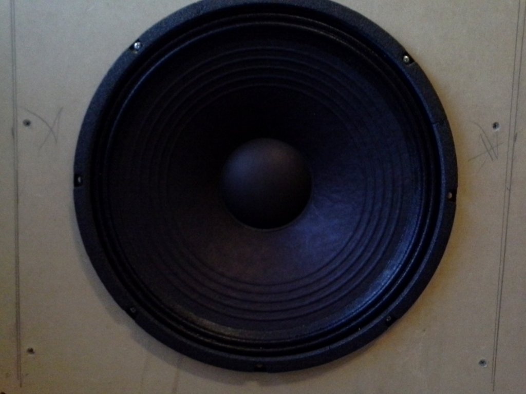

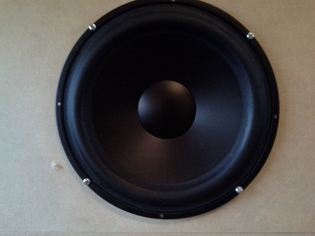

Starting with Aurum Cantus G1's (midrange tweeters), Morel MW-1075's (midrange bass) and Eminence Delta 15FLA's.
I'm just breaking in the speakers right now and will be experimenting with side wing/wings soon. Maybe add a back firing tweeter. Completed the crossovers and making sure those are correct before making a permanent home for them on some better looking material. Everything seems to be sounding fine. Very interesting. Really enjoying the new sound.

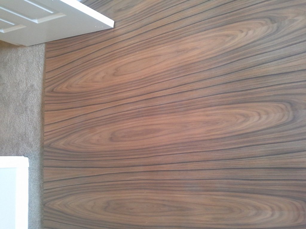

Rosewood veneer finally here.... 8)

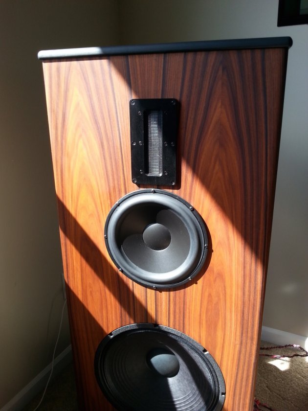

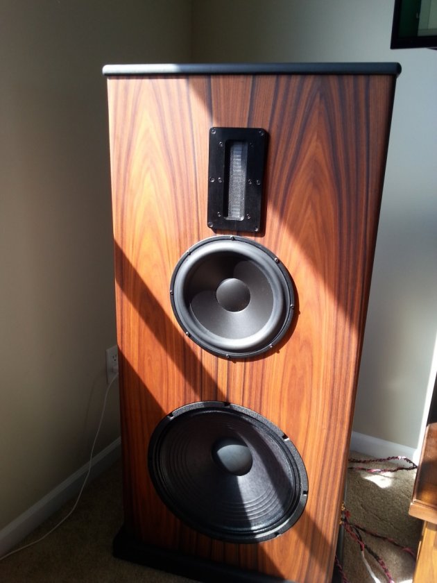

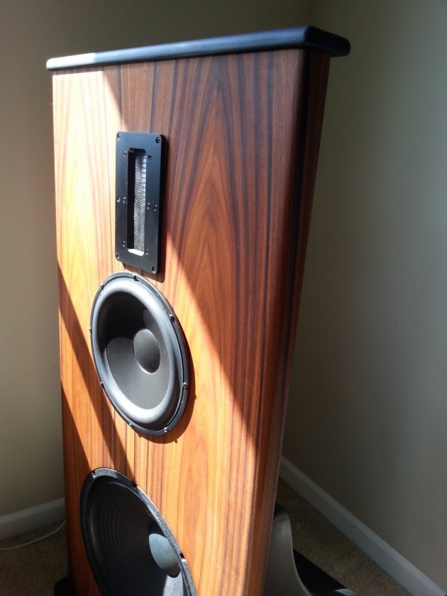

Not great pics, but, I haven't been able to do much lately. I need a nice sunny day to get better pics but, you get the idea...I finished these some time ago, just not the time to do the things I want right now.
The Rosewood came out very nicely. And they sound very sweet. I have a variable resister on the tweeter output, so I can dial them in. Same goes with the separate amp I use for the 15" bass driver. So everything is very flexible. Both outputs of my amps are also adjustable.

VERY NICE!  I rarely use all caps, but this deserves it - stellar build!

You're going to have to explain to people that you built those.  They look commercially done - in a good way!
Love the veneer work, just gorgeous.

It was a bit more frustrating than I anticipated. I had some thoughtful audiophiles advise me to stop and think about it a bit, before diving head first into it. Because it does take some effort to complete.  :scratch:
Secondly, I can see why the single driver OB projects are so sexy. Much easier to put together and the down side is probably small. Small or large coax-type drivers would be much easier to complete, and the simple design is very attractive, in sound and looks. Especially if the driver requires no x-over work or you can get the driver with a x-over already designed/built for you, IMHO.
I tried to get some help from various members of the audiophile community, but there schedule and my schedule just didn't work out, so I had to do it all on my own. But, I do have a work shop, so that does help. I was a bit confused on whether to put a cap on the top or not, but it does look better with it and seems to frame the Rosewood veneer. I'll try to get some better pics, later when I can. Taking pictures of my knives is far simpler/easy, than taking pictures of large/heavy speakers. You can trust me on that.
I might add that I do work with wood/steel, more than the average person, that has some form or function in completing the project. But, my shop is built/designed for knife making, so I had to do some adjusting. And, again, it was not an easy project. But, the rewards are very nice.
The main body is 1.5" MDF. The base is 2 1/4" thick. The rosewood is covered/finished in linseed oil, I cover all of my wood projects in linseed oil, it's old fashioned  :D. The rest is flat black automotive paint, to match the drivers color as much as possible. So almost everything has a soft finish. The x-overs are built on simple red plastic boards and the wires soldied on the under side for a clean finish.
