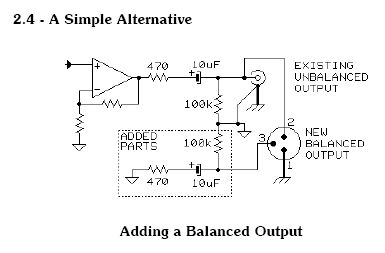

I run 25' balanced DH Labs cables with XLR/RCA adapters at the LIO end to Acoustic Imagery Atsah mono amps XLR inputs. Being Hypex NCore based, it has a differential input and they do recommend balanced connections (pins 2+3) from the source, even if it's a single-ended signal on RCA's.
Can you elaborate a bit on topology of the balanced line I/O you're using? Is it passive such as the Jensen example below, which provides balanced impedance, but doesn't drive differential signals (or add gain)? Or if it's active/differential, is it a discrete stage?

After experimenting with a few different configurations (passive transformers, active SE to differential conversion, and passive balanced impedance), I decided on going with the passive balanced impedance method w/o the transformers (similar to your Jensen example)
It simply sounded better to me (like nothing was being added to or taken away from the sound) compared to the others.
So no added gain on the LIO BAL OUTPUT.

Great! That seems like the best way to preserve the pristine transparency of the existing SE outputs.
