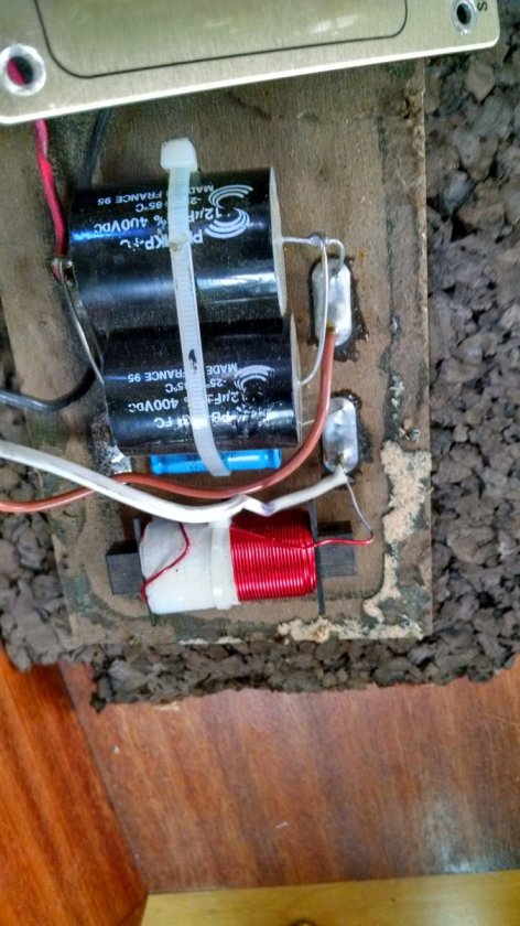

So my original crossovers have (2) 12uf capacitors. Should I replace these with (2) 15uf capacitors or just (1)?
Davey
Posts: 1481
Re: Magnestand MMGs - Crossover Upgrade?
Reply #18 on:
11 Mar 2015, 12:08 am »
Yeah, those are the older crossovers. I would recommend to replace with a single 2.0mH coil and a single 15uF capacitor. Plus a resistor in series with the tweeter for attenuation as you see fit.
Dave.
kappa546
Posts: 17
Reply #19 on:
15 Mar 2015, 08:46 pm »
What happens with the blue cap below the 12uF caps? I will also be upgrading crossovers on mmg's but I really don't know which design to go with. some swear by the SMGa design, there's one design that discusses a capacitor-less tweeter section that sounds interesting... I can't figure out which to go with. Also considering a line-level active crossover.
