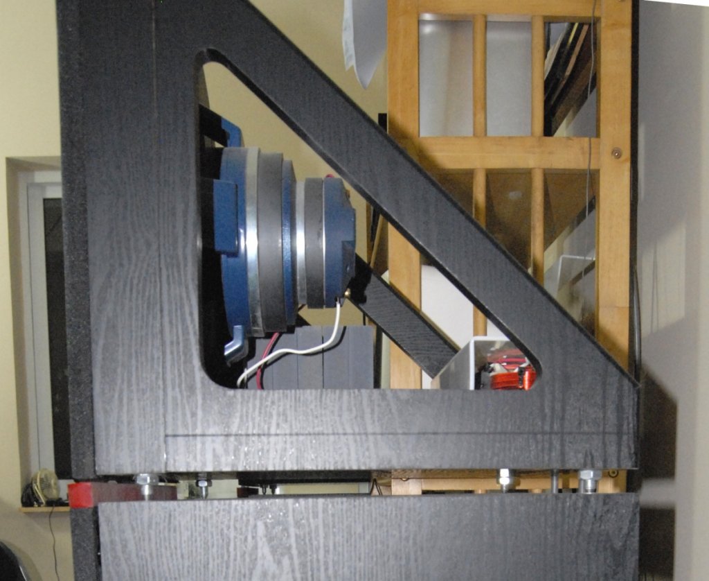

I don't know how I ended up with the image here, these are definitely not mine, way too good looking:
