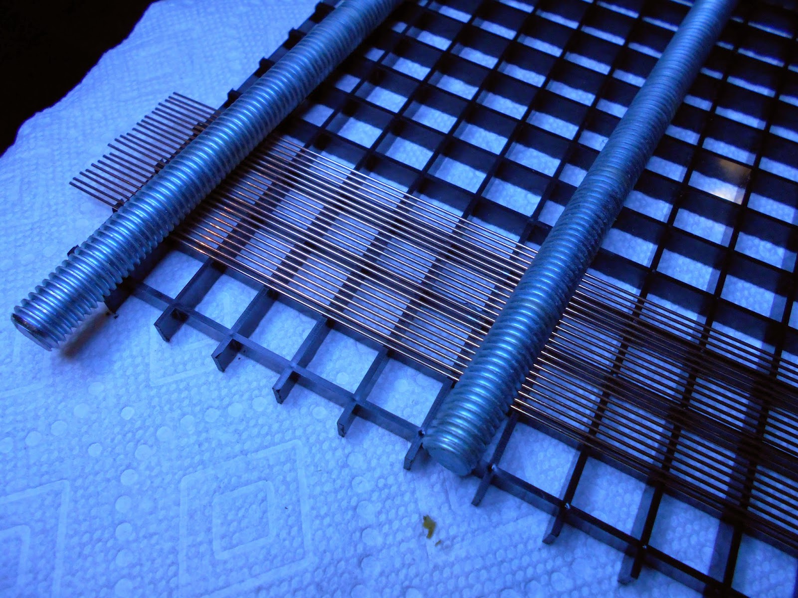

I’ve started an insane new DIY speaker project-- a hybrid electrostat with selectable dispersion modes.  It could be the holy grail or I could fall on my face.
Each stator uses a vertical array of (132) copper coated .035 diameter TIG welding rods glued onto a black plastic egg crate support (florescent light diffuser).
The conductors are physically segmented into (11) discrete groups of (12) rods, and electrically segmented into (6) discrete groups (center group + 5 outer group pairs).
In narrow dispersion mode, all wire groups are directly coupled to the amps/transformers; driving the diaphragm uniformly across its entire surface and the panel radiates a planar wave front giving a tightly focused sweet spot for best imaging and slam.
In wide mode, dispersion is achieved the same way Peter Walker did it in the Quad ESL 63; using electrically segmented conductors receiving sequentially delayed signals via a resistor/capacitor delay network.  But where the Quad 63 used concentric rings of conductors in a delay line, driving the diaphragm from the center outward, as a point source radiating a spherical wave front, my panels use vertical wire groups driving the diaphragm from the centerline outward, as a line source radiating a cylindrical wave front.
The stators are insanely tedious to build; especially considering that the 536 welding rods are only 36” long and the panels are 48” so I have to butt and solder/splice each one to 48” length.
No sane person would go thru this… two stators nearly done and two more to go:

It was then that I had a brainstorm about not painting the egg crates for the front stators, as they are most visible and would look much better without painting them (even with a clear coat).
So, for the front stators I'm painting the wires before I install them on the egg crates, and leaving the nice black egg crates unpainted.  Where the horizontal supports will be placed, I tacked on some 1/4" strips of wood with double-sided tape to hold the rod spacing and hung the rods up to spray them.
I just sprayed on the first coat of clear acrylic lacquer and taking a break to post this update.

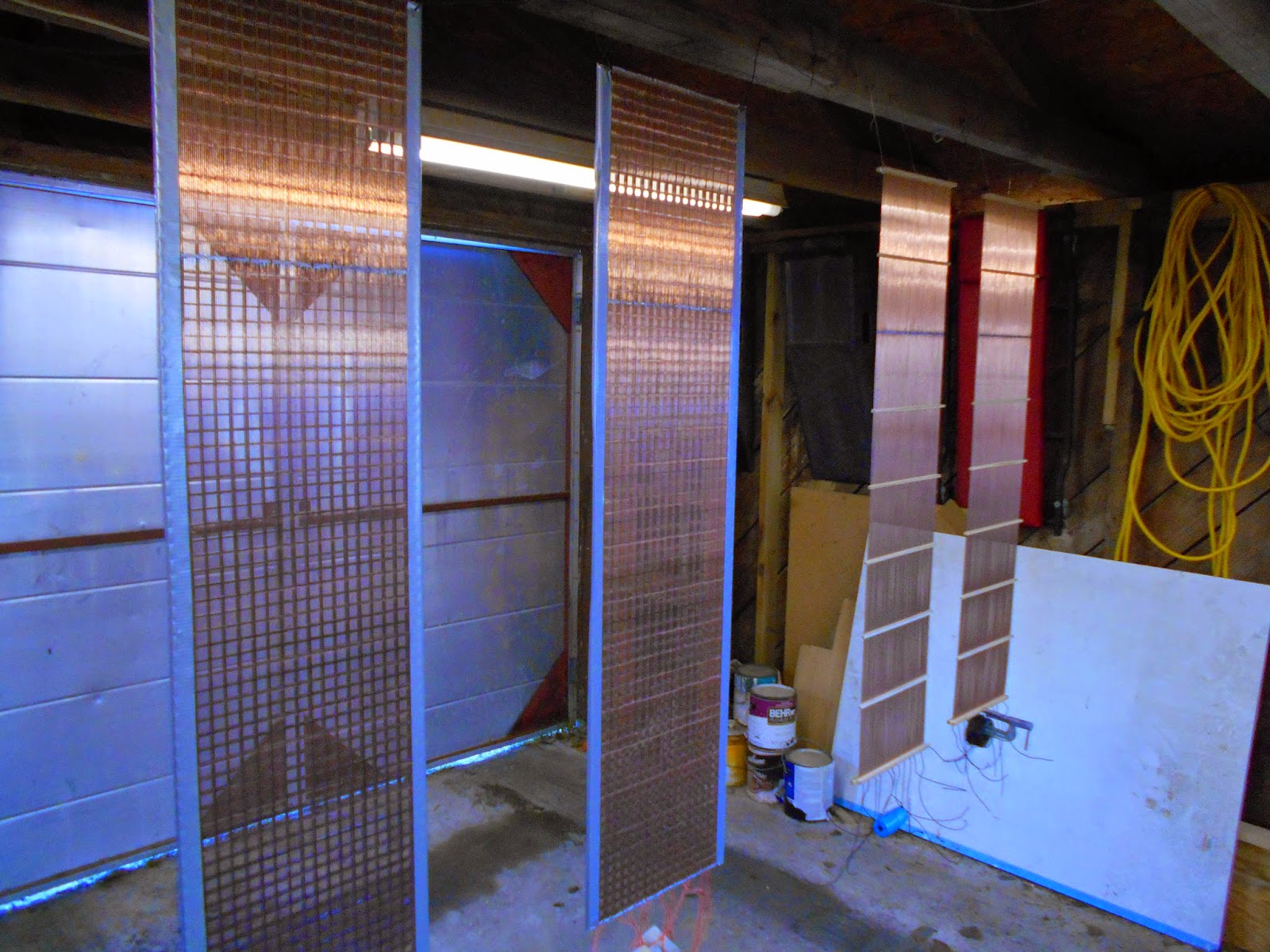

Update 2/13:
Hi all,
I've been down with bronchitis for a while but the project is now back on.
All four stators are completed, the diaphragms are tensioned and bonded to the front stators, and minutes ago I sprayed the conductive coating on the diaphragms (shown still wet in the photo).  I will let the coatings dry overnight, then assemble the panels in the morning.
And then I'm off to spend Valentine's day and the rest of the weekend with my China Doll... love that sushi
Jazz
Photo1 - Stator being bonded to tensioned diaphragm (on stretcher jig)
photo 2 - Completed front stator with diaphragm installed:
photo 3 - Front stators with diaphragms masked off and conductive coating applied (Licron Crystal ESD):

The panels are completed.   When the resistors from Digikey and the Soviet military rotary switches from Belarus arrive, I can build the resistor networks to make these panels switchable between narrow and wide dispersion modes.
