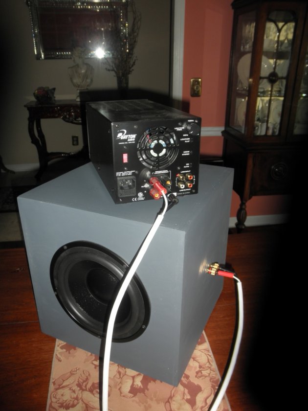

I've been using a single Dayton APA-150 to drive two OB Alphas per side in stereo. There's plenty of power on tap with the Alphas connected in parallel.
