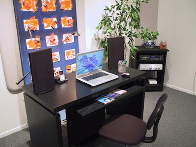

Hi, I don't know if you saw this one on the ER Audio site:
http://www.eraudio.com.au/Mini_Panels/mini_panels.html
That is not a kit but it seems to be about the form factor you are looking for. At one point I think he may have mentioned something about a kit so you could always ask about a kit version.
No personal experience with that one. Apparently the horizontal dispersion is improved over the earlier 440 panel.

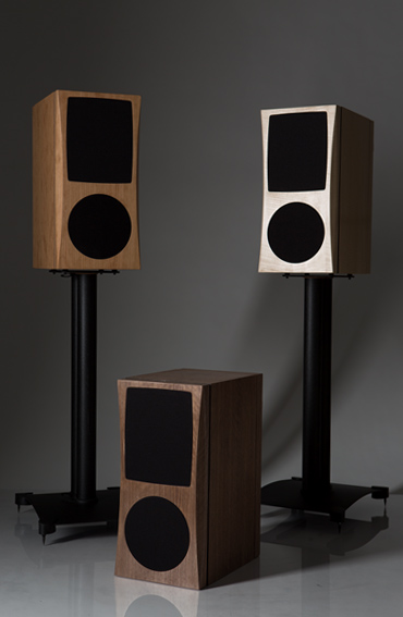

Not mini per se, but this is the smallest ESL I'm aware of.  JansZen zA1.1.

I've seen mini panels of ER Audio. But they are not small enough.
Thank you for your reply.
I'll check this out.

Except as relates to tweeters, the words "ESL" and "small" don't belong together.  ESL's need big surface aea to offset their limited diphragm excursion and dipole roll off.   Magnetic planars likewise suffer from the dipole roll off but can somewhat compensate with their higher sensitivity and excursion.
