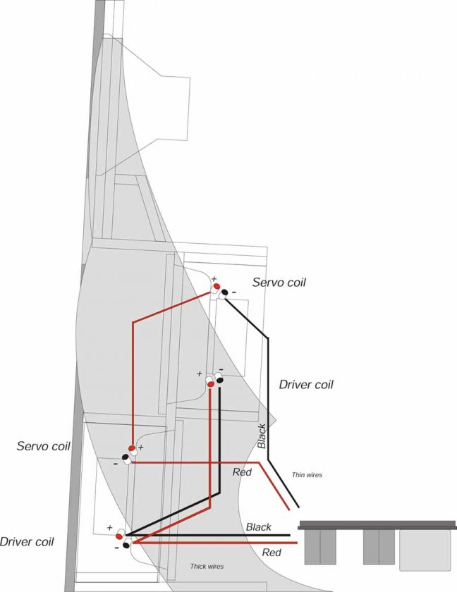

Oh boy - I understand about reversing on the driver coils, but I am not sure of how to wire the servo.  I now have it as just a series hookup.  Is there a diagram anywhere?
Re: Amp box dimensions for A370PEQ and HX300 amps
« Reply #8 on: 12 Jan 2015, 03:45 am »
I think I have the  PDF  here somwhere , if yo PM me your email I can send it to you.
Otherwise,    just run the pos  servo lead off the  amp  to the neg  terminal   on the lower  woofer (servo coil).  Run the  neg  servo lead off the amp to the neg  terminal   on the top   woofer(servo  coil).   Then connect the  pos of each  servo coil to each other . .  Done
-jay

Servo Sub wiring problem - I'm hijacking this thread
« Reply #9 on: 17 Jan 2015, 08:42 pm »
Is the servo wiring right in this above picture? One place tells me to wire this circuit serially but picture shows wire from + to + in servo circuit. I have wired as per picture and get huge constant blasts of sound when powered up.  When just speaker is wired it works as expected (but of course without servo correction)  I cannot figure out how to post picture here.

The servo wiring if both drivers were facing front would be +-+-, with them reversed direction they are - ++- since the main + lead goes to the reversed driver.

« Reply #13 on: 17 Jan 2015, 09:40 pm »
OK I have checked wiring multiple times.  It is now wired as pictured.  No incoming signal - When I move power switch to on the speaker erupts in a constant machine gun like stuttering LOUD output.  The only discrepancy is my directions say to connect the servo NEG wire to a red/black small wire from amp.  There is no small red/black wire from amp so I connected it to the small black wire - servo pos is connected to small red wire.

You've got something  "crossed " then.
 It's easy to get  a couple of the terminals  reversed with the  4 pole connectores   .....  if you orient the connectors so there is  top/bottom and left right poles (looking fro rear of each connector) ,  the top/bottom  stay the same on  both the male and femaole  halves but the left/right have to be reversed so that when you put  them together,  they  all l ine up
 My description above  and the pic  match, and they are for a   forward / rearward  facing pair.  Make sure you have the   two reversed polairty  coils  on the same driver
-jay

Just folow this, same as my post above.
Take the  pos from the amp and run it to the neg of lower driver (servo coil)  .  Run a jumper  wire  from the Pos of that same coil (lower servo coil)  to the + on the  the upper servo coil.   Run the Neg from the amp  to the Neg of the  top servo coil..
It's still in series, it's just reversed the lower servo coils polarity to match the   lower  driver  coil being reversed  :)
Like mentioned above, if the wiring is done like this (matches the pic)  then something has to be crossed.   Take the  connectors out  of the equation temporarilly to test.
-jay

Got it figured out late last nite.  I was working from a drawing that included an incorrect section based on comments from an old  post.  All the recent guidance from Captainhemo and HAL has been right on the money and much appreciated.  Will post a picture in a couple of days when I get it all cleaned up.
