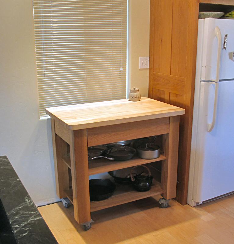

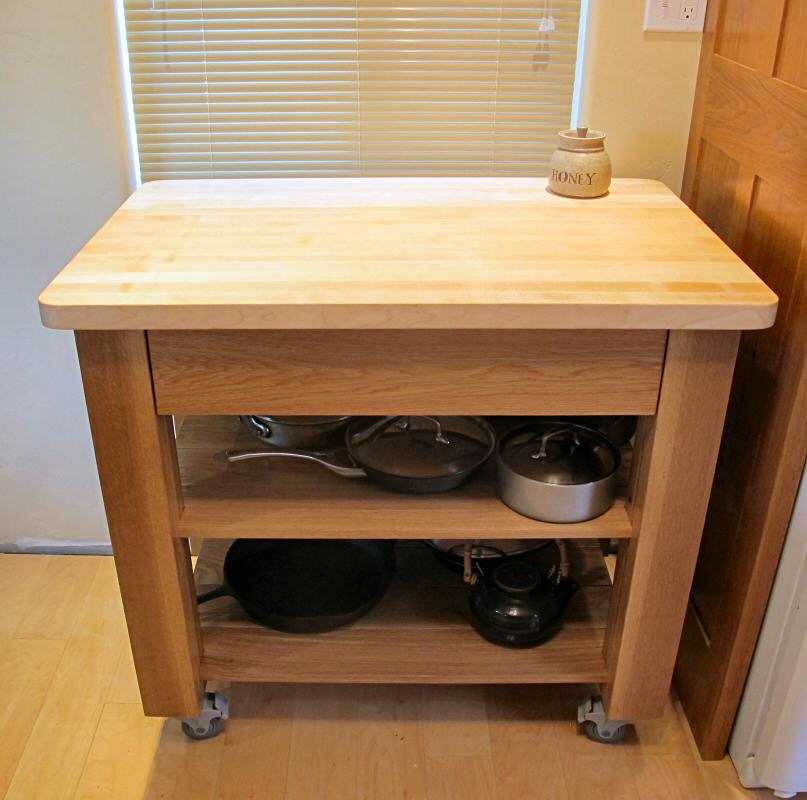

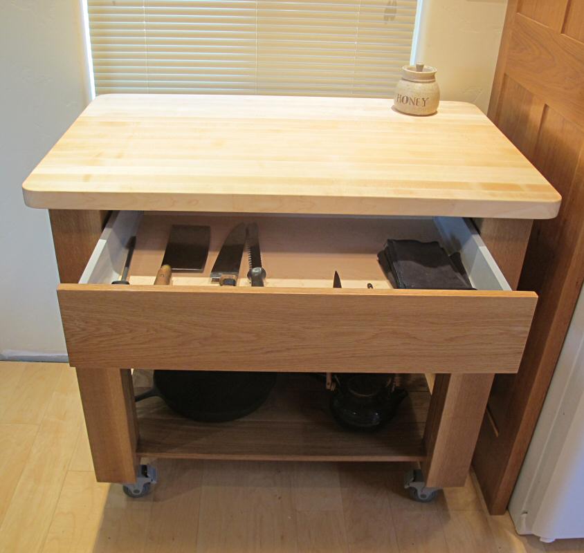

Nice looking chopping block Bob. A solid maple edge band around the plywood would be the finishing touch. I finished my top with a pure tung oil/citrus finish which is non-toxic when dry. Woodcraft also sells a butcher block oil.
If any of you woodworkers have pics of cutting boards, I'd love to see them.
Well... since you asked, more of a chopping block than cutting board but what the heck.
White oak base with 40" x 25-1/2" hard maple top. The legs are 4" square because the caster plate is almost that big. Total height is 36-1/2", the same as the counter top. The wheels are 3" nylon antimicrobial from Alco, $71.80 for 4. http://www.alcosales.compc_product_detail.asp?key=78B7D2E6E2F34D4CB735CAE0AB26FF38

That's a good looking piece Wayne, very classy. Regarding those casters, a very close friend of mine sells casters, if you ever need any, let me know and I'll hook you two up.
