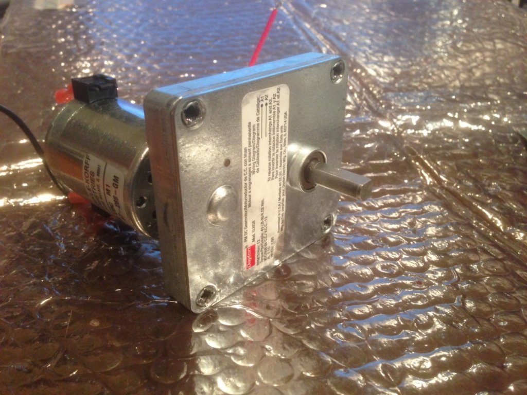

Gearmotor - Dayton branded but Merkle-Korff designed/built, model 1LNG8.  I wasted lots of time looking for appropriately spec'd AC gearmotors until I got smart and considered DC.  This one is 12 RPM, 12V DC with 40 LB/Inch torque and 40 LB overhung load.  It's a monster  compared with the AC gearmotors mentioned most frequently in the forums (e.g. - 13 LB/In, 3.5 LB overhung load for the Dayton 3M153).  You can learn more about gearmotor basics here: http://www.motioncontrolonline.org/files/public/Gearmotor_Basics.pdf

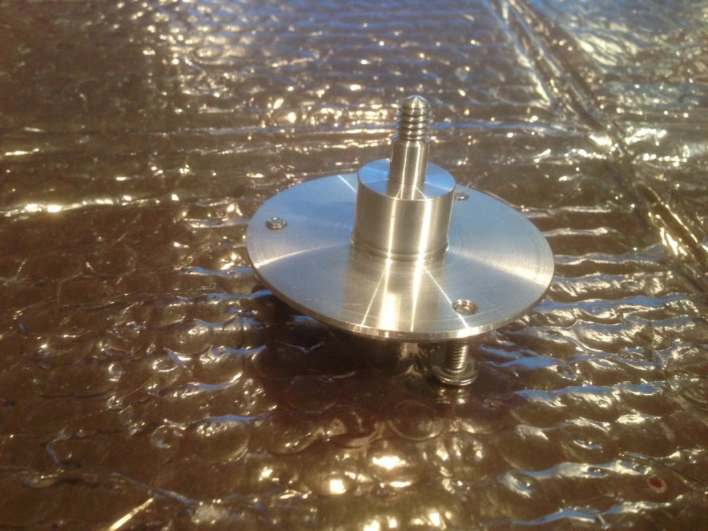

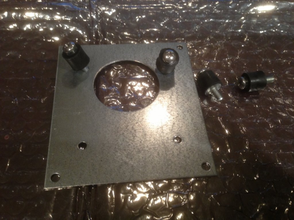

I decided to get the spindle, bracket and rubber mounts from VPI.  Just seemed wise.  Turns out I will not need the bracket and rubber mounts.  Anyone want to buy them?
A 3/16" inch ball bearing on top of the gearmotor shaft provides just the right clearance for the spindle-platter assembly over the aluminum deck.  [not pictured]

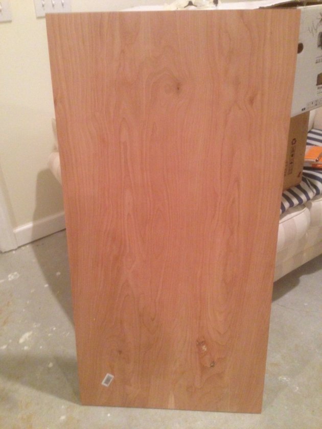

MDF has been problematic with VPI 16/16.5's and some of the earlier premium models.  I decided to build the basic box of 3/4 inch birch faced plywood and it will be liberally coated with the appropriate varnish.  The Typhoon is made of metal but I don't have the tools to work up a metal case.  Metalwork products have escalated in cost the last few years.  I wonder if a metal toolbox would work?

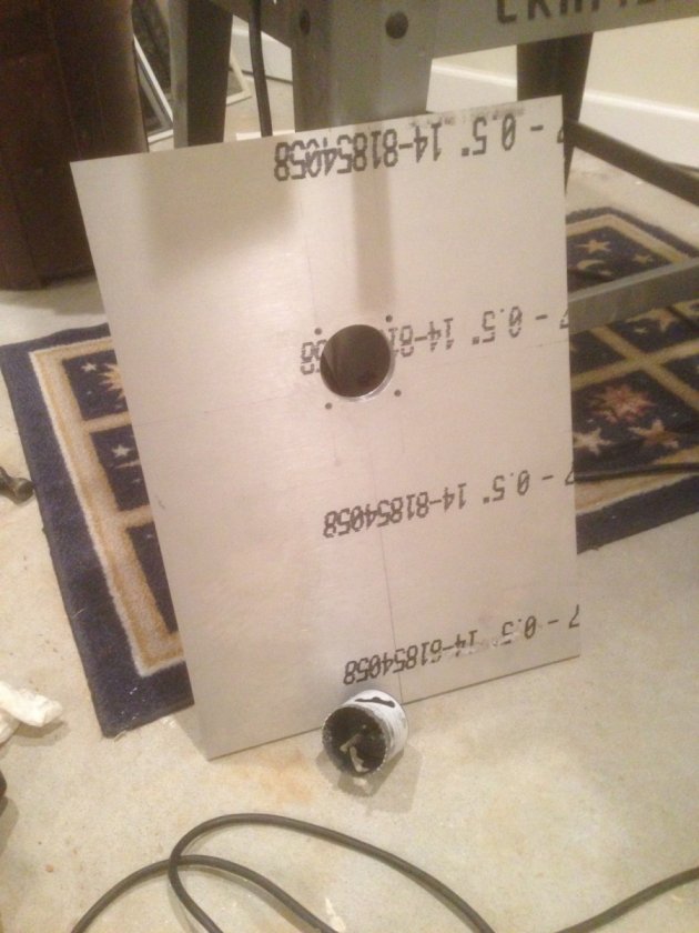

The deck was a poser for quite a while, but I went with half inch thick aluminum plate.  It seemed like a good idea at the time, but today I couldn't tell you why.  A local metal distributor cut a small piece at a price competitive with what I saw online.  Once I decided to go with the plate, the bracket and mounts became unnecessary.  But then I had to figure out how to mount the gearmotor with the spindle attached.  The solution was to cut a 2.5 inch hole that allows the spindle to pass through and then move laterally to the correct position.  Mounting holes were calculated and laid out to put the spindle at the right position.
So, I need to drill another hole for the vacuum tower, its placement being critical.  A drill press would be nice but it would need to be a biggie to accommodate the dimensions of the deck plate.  I did ok with the first hole with a beefy hand drill, paying close attention to the bubble level to keep things as plumb as possible.  This is the first time I have worked with this thickness of metal plate.  It came out OK in the end... so far.... You can see the 2.5 inch hole saw used.

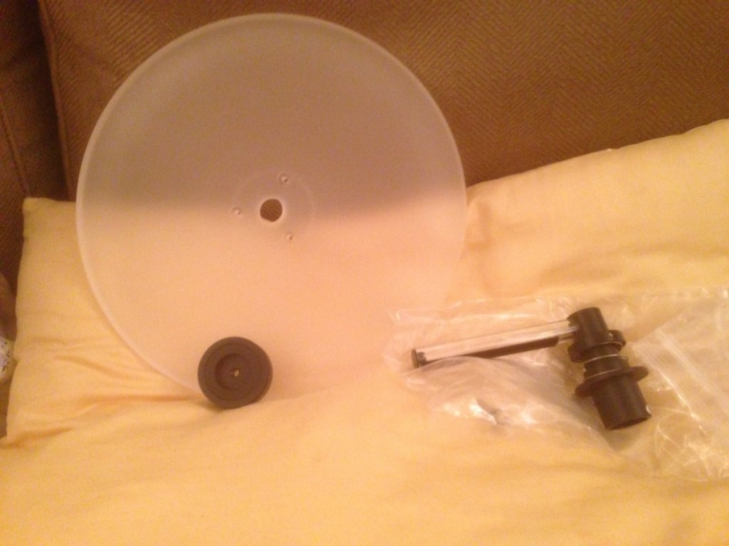

And here are a few more items, acrylic platter, disc clamp and VPI upgrade kit.  I got the platter online and the other things from Elusive Disc along with some disc doctor cleaning pads and liquid.
