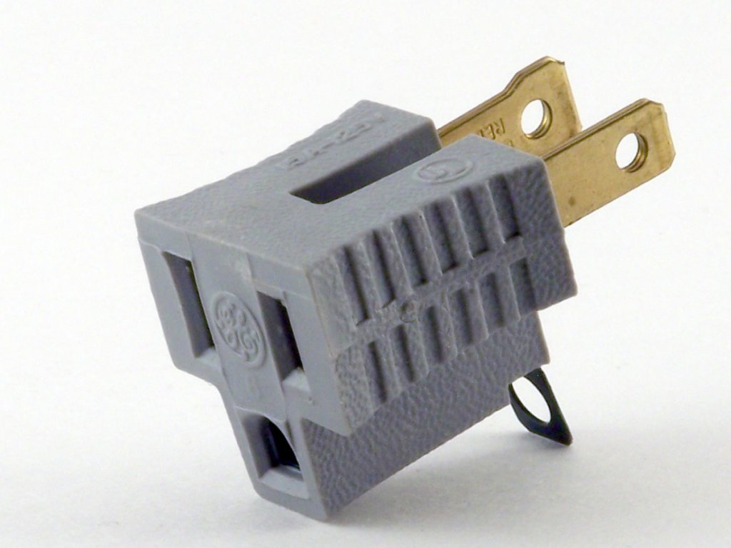

I have a hum coming from my music only  powered subwoofer,with nothing plugged in,only powered up.Here is what I have tried so far with no success:
-plug into a different circuit
-use a 'cheater" cord,3 to 2 prong
-changed out xlr cables
-removed the ground(shield)from pin#1 on the speaker end
-tried a Ebtech Hum-X hum eliminator
I have tried a plug-in circuit tester and all good.
This is a 'pro' type music only subwoofer with xlr's,whereby the signal goes through the sub x-over at 80hz and from there to my powered Yamaha tops.
Not sure now if it's my sub or my house wiring??!!
 Gound loop,I guess?! What next to try?? Thanks,Huck

Try using a cheater plug on the power cord. it eliminates
 the ground pin. This worked for me.
I basically tried the same thing,by cutting the ground pin off one side of my 3 prong power cord and no change....these "cheater plugs"are illegal here in Canada,so very hard to find! I changed out all my 4 xlr cables to a different brand and the hum is still there,but has dropped from 48.5 db to 43.5db which is more tolerable. Thanks,Huck

Using a cheater plug can be dangerous - http://en.wikipedia.org/wiki/Cheater_plug

Here's another write-up on the dangers of cheater plugs - http://www.ehow.com/info_11373614_three-prong-plug-converter-safety.html
If you are going to play your sub on a wet concrete floor.........Remember, your body has to become part of the circuit, and your environment has to be rich in conductivity. How the "nutty professor" got zapped in the Wiki article is a puzzler. All high fidelity equipment does not need a 3-prong plug, (unless it's used against the usual recommended installation environments.....which is indoors on dry floors).
I have 8 amplifiers and none of them have a grounded plug.

Some other forums don't permit posts suggesting dangerous practices like cheater plugs.

I never suggested once on using a "cheater" plug. I said that grounded equipment in a home environment, under normal operating conditions, is simply not necessary.
My 8 amplifiers have no ground, and that is the way they came from the manufacturer. A couple of the amps are relatively new.
Industrial or commercial equipment is a different story. They actually might end up in service outside in the rain or at least in the elements, unlike a typical home (unless your home has a leaky roof.......).
