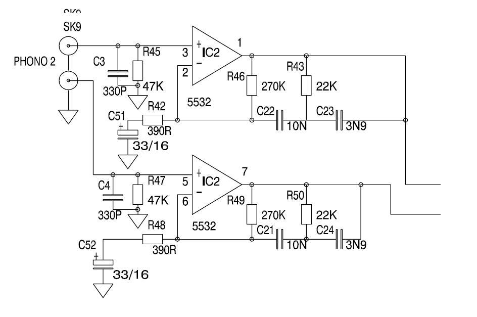

I am glad I found another phono schematic. Before I post my sketched diagram of your described modifications (I'm working on that) I would like to point out that this new schematic is of a famous (and reliable) mixer Xone 62 -- industry standard for sound quality for what it is. It is also a Single opamp but I believe they are doing what you propose, already. I see no coupling caps in the signal path, compared to the previous schematic. It seems this second one is a better phono, no? Better opamp, no caps, is this the best one can do with a single opamp? Can I then eliminate all coupling caps in the previous phono schematic in a similar way? In other words can I use this for ideas to incorporate into my phono?
regards,
Herman
regards,
Herman
This new schematic is very similar to the other except the absence of two coupling caps.  However there is still the large electrolytic C51 in the signal path.  It may not look like it's in the path but that cap is in the feedback circuit which determines the shape of the RIAA curve.
C51 would be the big offender then and would benefit by being replaced with either a high quality film cap or modifying the feedback circuit in a manner similar to what I described before so that one of smaller value can be used.
This circuit however is only calling for a 33uF cap.  Lower voltage film types aren't overly huge and should probably be substituted.  If you're building this yourself, just lay it out with a high quality 33uF cap instead of the lower quality electrolytic.
This would be a nice cap for that job.
http://www.mouser.com/ProductDetail/WIMA/MKS4C053306F00KYSD/?qs=sGAEpiMZZMv1cc3ydrPrFwgzP98AO9idlpSl64Eu2%2fg%3d

Dear Pete,
Going back 2 posts, I drew up the modified (per your instructions) schematic. Please take a look and verify that I understood correctly. If so I will proceed with both channels, I have the needed parts to do this. Only showing one channel mods for clarification.
Also, can I simply omit the (1uf) output cap, as done with no issues in the other, posted above, schematic? Or do you still recommend to keep it?
best regards,
Herman
best regards,
Herman
You almost got it.  The input and output caps can be omitted but you need to move one component.  R121 needs to connect to the node that connects R129, C117 and R125.  So disconnect R121 from the (-) input and move it to the other side of the new 1uF cap.
The only components connected to the (-) input will be the 2M resistor and the 1uF cap.
That particular circuit does have what seems to me an unusually high low frequency gain.  As it stands, the gain is 60dB which seems a bit high to me.  The other circuit, with the 390 Ohm feedback resistor had a more reasonable gain.  Depends on the cartridge of course, but if its putting out 2.5mV, then the circuit with the 100 Ohm resistor in the feedback will be putting out more than 2V which may or may not be an issue depending on how the downstream volume control is implemented.
Were it me, I'd increase R121 to at least 150 Ohm.  That will lower the gain from 1001 to 668, more in line with the circuit using 390 Ohm in the feedback.  And consider increasing the 2M resistor to perhaps 5M.

Dear Pete,
Like this?
I updated R121 to 150ohms, but can do any value now that I am changing it. As far as the stock opamp -- it's mc4580.
http://www.unisonic.com.tw/datasheet/MC4580.pdf
Is there any point of replacing it with NE5532? Just going to be a different sound, not necessarily better? Should I bother with this, in you opinion?
Thank you for all the help! I am looking forward to comparing stock with your mods, and plan to clearly post my findings.
Best regards,
Herman

Dear Pete,
Like this?
Best regards,
Herman
That schematic is correct.  And rather than the NE5532, go with something like the LT1113 which has J-Fet input devices and a much higher input impedance.

Re: Transformers instead of resistors
« Reply #15 on: 21 Dec 2014, 12:26 am »
The OPA1611 or OPA1612 with 1.1-nV/√Hz noise and a THD of  0.000015% might also be a good choice. This same opamps are used to good effect in the Auralic Vega.
Scotty

« Reply #16 on: 21 Dec 2014, 03:29 pm »
Scotty
My only concern with those particular Op-amps is that they do not employ J-fets for input, and with the large feedback resistor (5M) a higher input impedance will reduce output offset voltages.
That said, if the builder isn't averse to adjusting the offset once the circuit is built then the OPA1611 would be an excellent choice.

Years pass, and I practice smd soldering. I am back to this phono stage mod!
post#13 was a recommended modification to original Ecler phono stage. Is this still holding true today? Any other recommendations to reduce the noise and improve the cheapo original circuit?
thanks!
