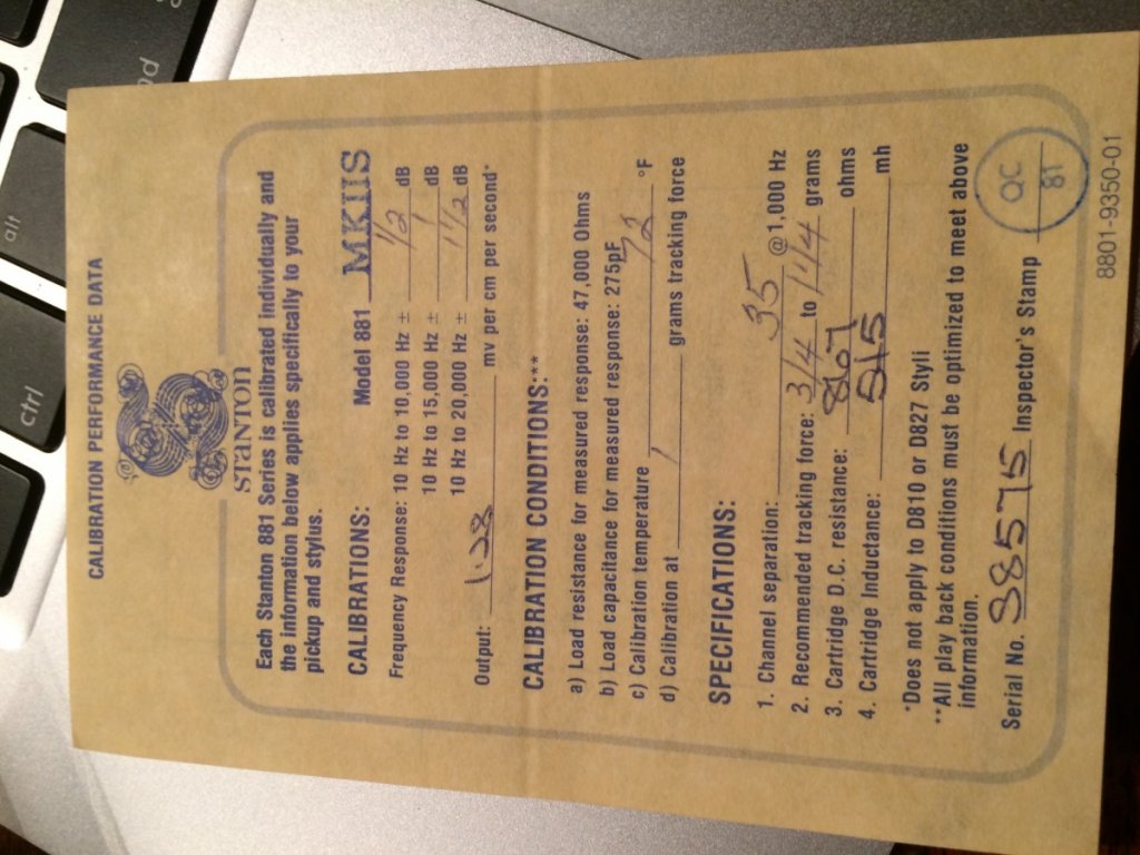

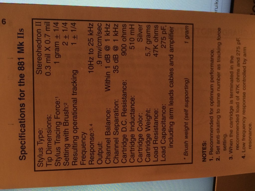

Found this in the box:
275 pF
And
Marius
James Tanner
  • Posts: 21005
  • The Demo is Everything!
    • http://www.bryston.com
Re: added Phono bp1.5, all sound distorted...
« Reply #8 on: 8 Dec 2014, 08:32 pm »
Ok so it looks like 275 PF - Mike will be in touch on email shortly.
james

2 main issues:
1- 275 seems a lot more than max 196 in the bp manual, though it worked before
2- could this have blown the bp26, (and what to do) without interfering with the output to the BHA1 connected through the tape out.
Marius
