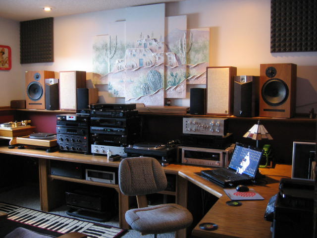

Wayner
Re: Speaker at wall - Deep Soundstage Possible?
« Reply #6 on: 19 Nov 2014, 03:28 pm »
It is indeed possible. I have 4 sets of speakers in my vinyl room that have a very wide and deep sound stage and they are sitting on a shelf 4' off the floor with only inches behind them. After many hours of adjusting, each has found it's own unique resting place, ideal for my near field listening pleasure. Listening in near field is part of the equation. It basically takes the room nodes out of the picture.
The speakers are (from the outside inward) a pair of Dynaco A25XLs modified, Focal 706v, AR-4X and some Paradigm Atoms v.3.
Wayner
Blackmore
« Reply #7 on: 19 Nov 2014, 03:35 pm »
Sorry about the OT, but Wayner, that is such a cool setup.
rollo
  • Posts: 5530
  • Rollo Audio Consulting -
« Reply #8 on: 19 Nov 2014, 03:47 pm »
  Love the Piano carpet. Nice touch.
