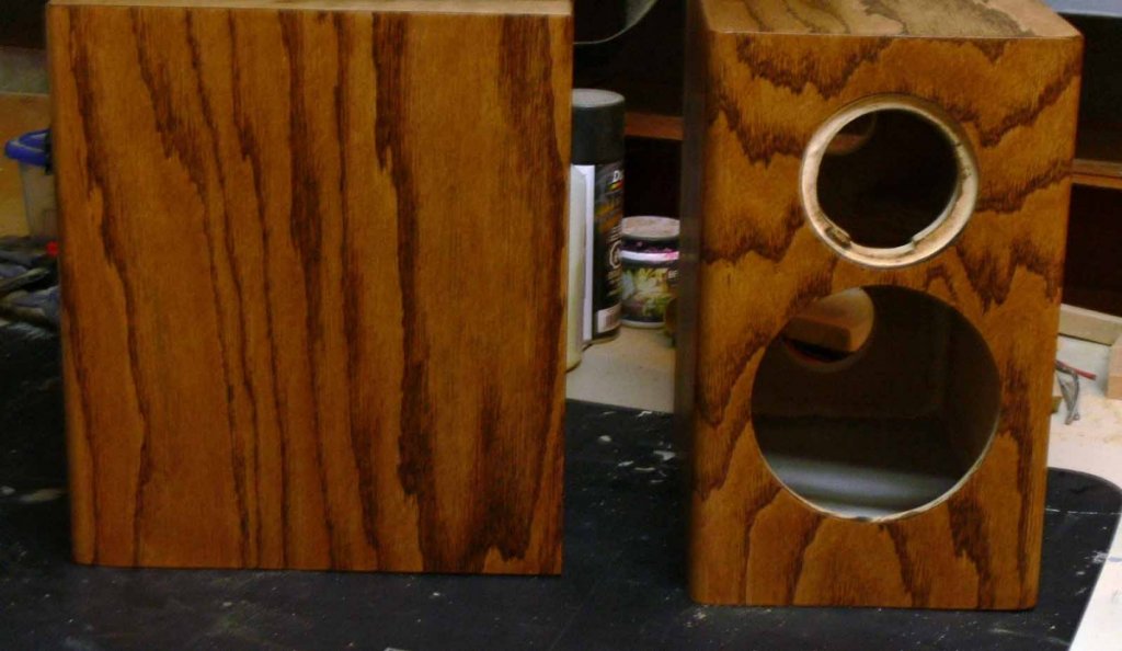

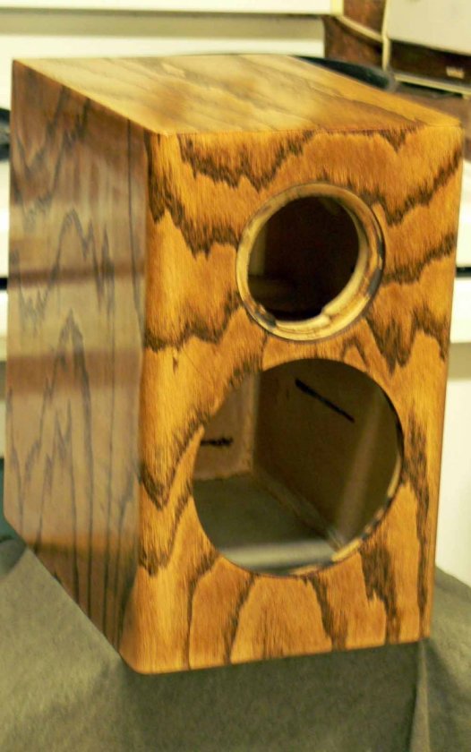

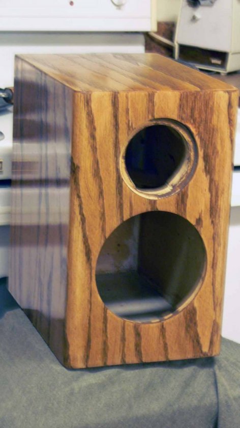

Just  a couople  pics showing  the finish after the intial 30 minute oil soak and  2  wet sanding with the oil sessions ( hard to get  good pics of the surface).
There were still  some areas I wasn't happy with so  another wet sanding session   took place this evening.  Hopefully  I'm  happy this time and can get going on the  Poly in a few days

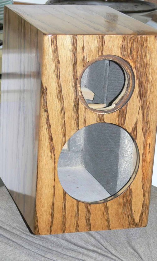

Here is a shot of each cabinet  after 3 coats
I'm  going to do another 800 grit sanding  then apply another really thin coat , maybe 2.  Will finish up with  some 1000 or finer paper and a good rub.
While I do like the   poly finish and  it will definitely add  a significant amount of "protection",  it does take away from  tha natural  look of the oil finish some .  You do end up with that coated look,  not necessarilly a bad thing  ,  just different.
-jay

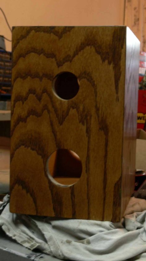

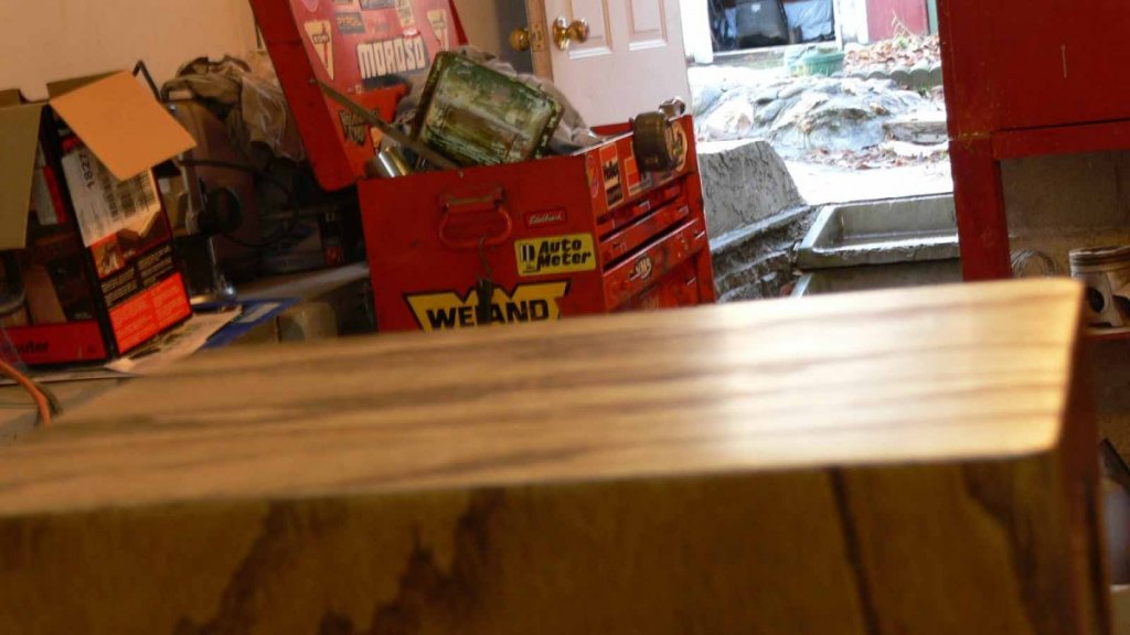

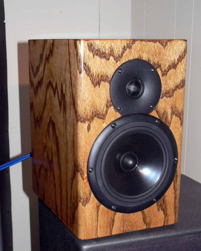

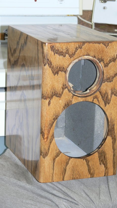

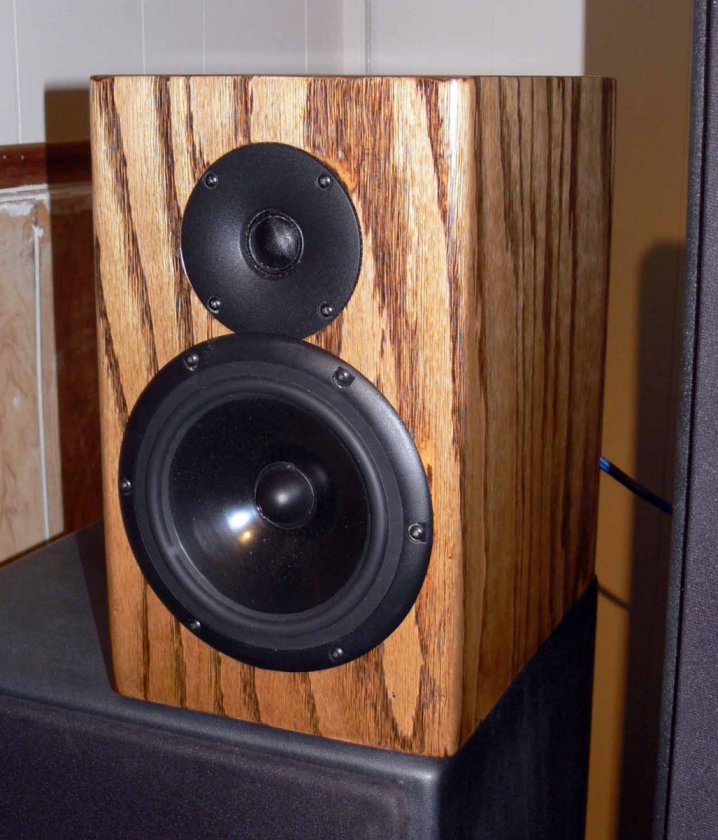

Finally got  to finishing up on these cabinets.   After  I posted those  last couple pics,  I  wasn't happy with a few spots and tried sanding a few scrtches out of a couple  areas .... bad move as I went  through the poly and into the oil finish lightening up  some spots..  I quickly found the only  real way to fix it was to completely sand off the poly frm the baffles and side panels on each cabinet,  I  just couldn't get an  even  color  doing it any  other way.   So, thjat is what I did and needless to say, it really wasn't much fun.  Took a long time doing it all by hand but  I eventually got all the  poly off and was able to apply  another couple   coating of   the oil and get the color even again.  After  letting it dry  for  a few days again,  I started re-applying the poly.
These  two pics will be very similar to the above but they are different,  they are  the  cabinets after  reoiling and re applying the  poly
Not sure  if it's really noticable in the pcutres, but I am  really glad I  went to the extra trouble of doing this.   I was able to fix the  edges up much better and get rid of the   few scratches that were  really bugging me..  The issue with the edges was caused  from  using the veneer trimmer while trimming across the grain, caused little tear outs  and chips.
These were assembled using the stock cross overs ,  I did add a .1 uF Vishay Roderstein bypass cap to the  woofer circuit and lined the cabinets with no rez.  The tweeter cutouts did not come out perfect due to the issue with the  flush trimming  of the veneer over the precut tweeter rabits. I won't do it this way again, lesson learned.   I actually thought the issue was going to be worse than it was
Again, as with the first pair of these I built for my neice  ,  I was  very impressed with these.  Not sure if it   is the  extra bypass caps, the no rez,   or a combination of the  2,  but the bass is definitely cleaner and I'd say faster I also used a bit more acusta stuf in these cabinets... went   with 1.5 oz in each cabinet instead of 1 oz  which I used in the  previous pair.
As many others  have said, these things are a steal at the  price  Danny is selling them at.   With a sheet of norez and the  couple Vishay caps,  the parts total   was only $214.  My room is  18x12 (approx) and  my amp is  pushing out  about 34wpc  where my tubes are biased, and these little guys easily fill the room, Ihaven't even tried them with the  subs yet .  .  I  just listened to   Double Vision  (Bob James/David Sanborn) and  the sound  was  really  nice. When you sit there and listen and think of the price,  it kind of makes you scratch your head a bit.
For anyone wanting to try veneering for the first time here are a few  things I  learned that may  prove useful
It isn't overly diffuclit,  just take your time and read lots.
I was worried about  using the  PVA as an adhesive  but it worked  fine. No adhesiion issues,  just  coat both  the  substrate and the veneer, let it dry,  then   iron it on  with a  clean  cotton  piece between the two.
A veneer trimmer works great when trimming  with the grain but  not so well cross cutting.  Next time I'll  use  some frog tape and  flush trim bit in my router (run the bearing on the tape, thanks Mike).
Wipe on Poly  works  well    but if you use  any  color under it, be extra careful  not to  sand through or you'll have a really tough time getting the colr back  even which was why I ened up sanding back to  the 90 degree corners at the back  edge  of each side panel.
Don't precut any rabits unless they are  very deep as  a flush tim bit  , even with a thin bearing,  won't  work to trim them out after applying the veneer..  You can get some bits  with a thin shoulder instead of a bearing  that some guys have usied, but  I'd  just cut these   holes after the veneer has been applied.   Plain cut outs are fine as you end up with a  decent surface to run the bearing on,  just be careful  of those shallow rabits.
When I disconnect them and  pull them  off the H-frames, I'll  grab a couple more shot  including the rear of each  cabinet.
Was a fun project and now I'm not scared to veneer anymore   :D
-jay
